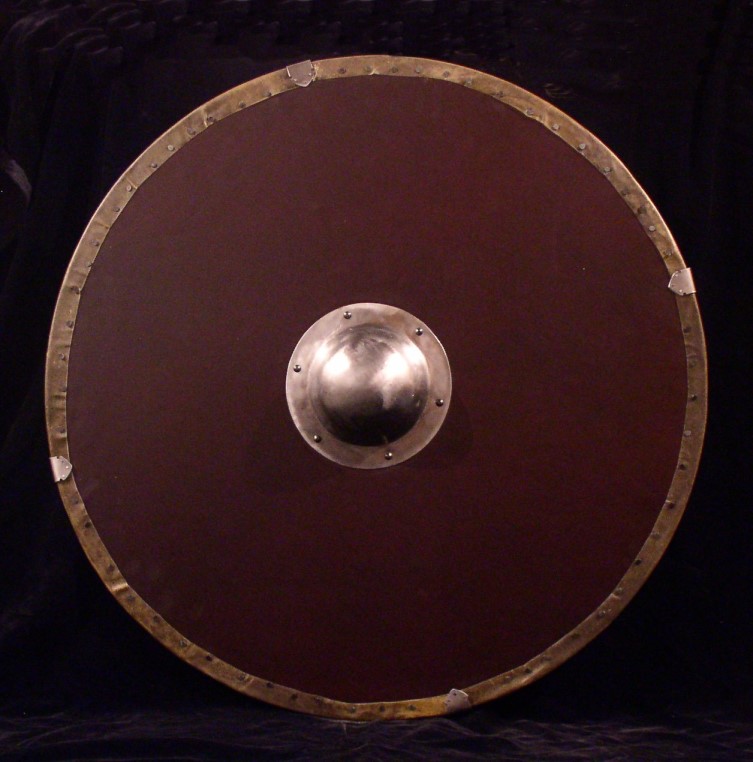

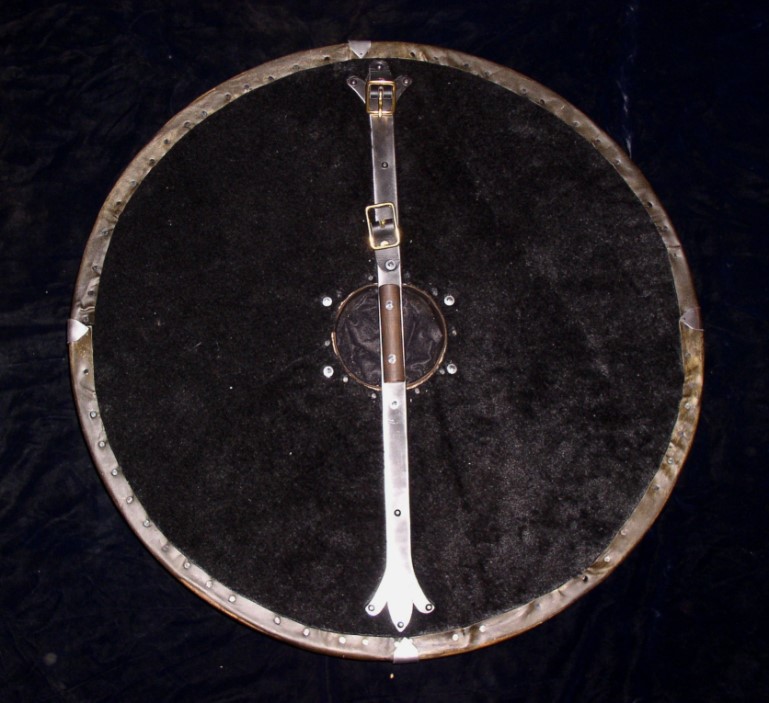

PostPosted: Mon 15 Nov, 2004 3:21 pm    Post subject: Here's the new round shield         Reply with quote
The buckles on the shield back are for the detachable sling strap(included) .
 Attachment: 115.24 KB
Back of the shield
 Attachment: 103.88 KB
Shield front

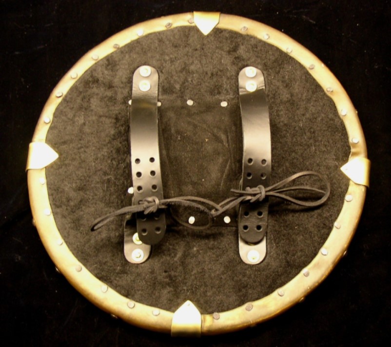

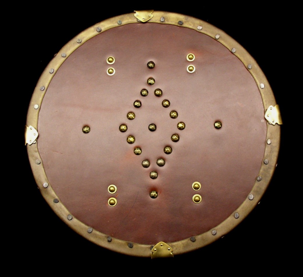

PostPosted: Mon 15 Nov, 2004 3:23 pm    Post subject: New (and improved) wooden buckler         Reply with quote
Here are the pics
 Attachment: 123.65 KB
Buckler back [ Download ]
 Attachment: 124.66 KB
front [ Download ]

The viking shield looks great! Please provide more pictures! What time period is the insipration for the buckler? I am really looking forward to a nice kite shield to use with my Norman and Templar. Ahh! the resistance in buying any non-sword items! I must remind myself that my swords are not truly complete without the requisite shield, even if I will be holding everything backwards. . . WTF?! Left handed warriors unite. Big Grin

The use of "nayles" on the front of wooden bucklers(they serve to break up a cut . in other words when a slashing stroke is parried the heads of the "nayles"cause the blade to skip across the surface of the buckler taking a little blade control away from an opponent and causing less damage to the buckler face . ) has obvious scottish conotations to it but was
to be found used around Europe . The earliest examples i've seen with what seems to be "nayles" are from 15th century
illuminations . Given that bucklers were in use for at least several centuries before this it is certainly possible that thier use to augment the surface of wooden bucklers could have been earlier.
The straps are adjustable and there is a stuffed leather pad at the knuckles .

Allen they are made from 1/2" thick red oak plywood and do not taper from boss to rim . We went with ply rather than plank for the obvious reason of keeping costs reasonable for an off the rack product (cross grain plywood is a stronger construct for resisting splitting as well) . I'll throw one on a scale today and post a weight .We mulled over doing them in several types of wood ( while the literary evidence from the period mentions linden or lime wood the archelogical evidence dose not bare this out . from english finds alone alder,ash,beech,birch,lime,maple,oak and poplar or willow have been found used in round shields ) so there would be say birch, poplar or oak avaliable but for the sake of uniforminty for production opted to go with a single wood .

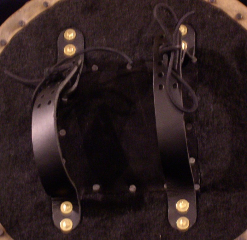

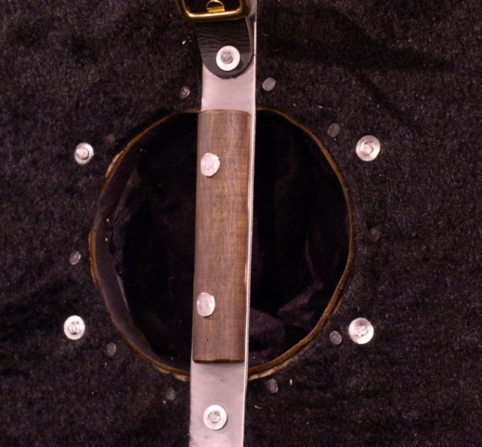

PostPosted: Tue 16 Nov, 2004 2:57 pm    Post subject: close-ups         Reply with quote
Here are close-ups of the grips/handles. The boss of the round shield is padded and there leather trim around the grip area . The boss flange is not flat against the shield face but inclined about three degrees . This is something we discovered during our research . This was done to give the boss some spring when struck . The round shield weighs about 6 1/2 lbs and the buckler about 1 3/4 .
 Attachment: 111.55 KB
 Attachment: 110.52 KB
