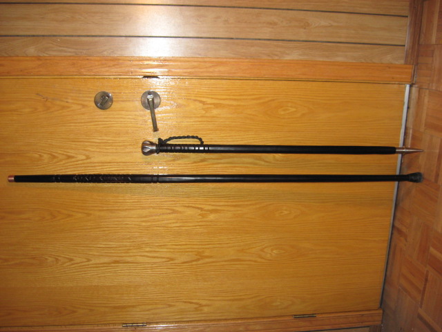

Staff next to a Walking stcik with a steel head.

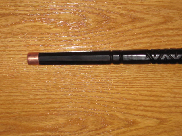

Close up of top with copper cap.

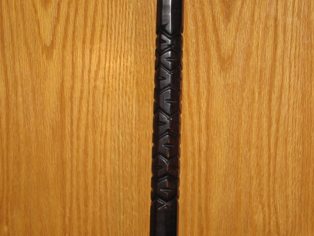

Octagonal section with carved grooves.

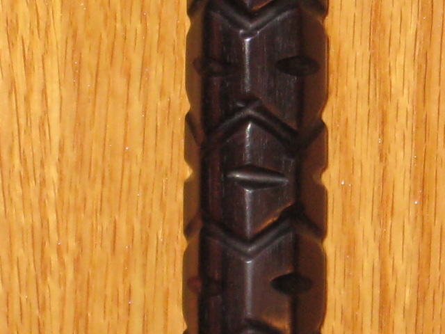

Extreme close-up

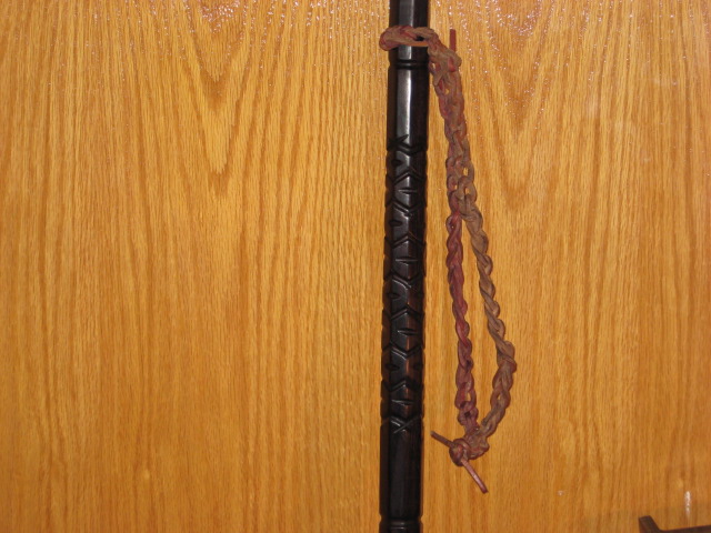

Medium close-up of staff with wrist strap.
