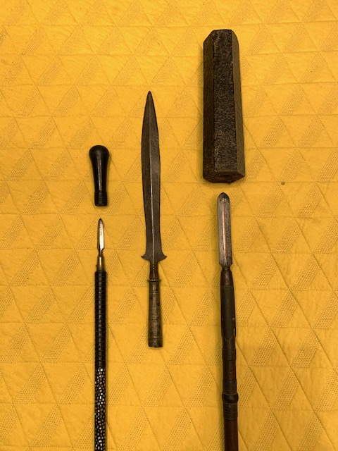

Yes I think you are right here but there are also many examples of tanged spears (see below image, right to left: Japanese kago yari, Malaysian spear, long yari). All three of these spear heads are tanged, however, you can see in each case that the tanged spear is combined with a ferrule or some type of external shaft reinforcement. Note: the Malaysian spear looks socketed, but this is a brass ferrule which would have been on the outside of the shaft, and inside is a tang that would have been inserted into the shaft.

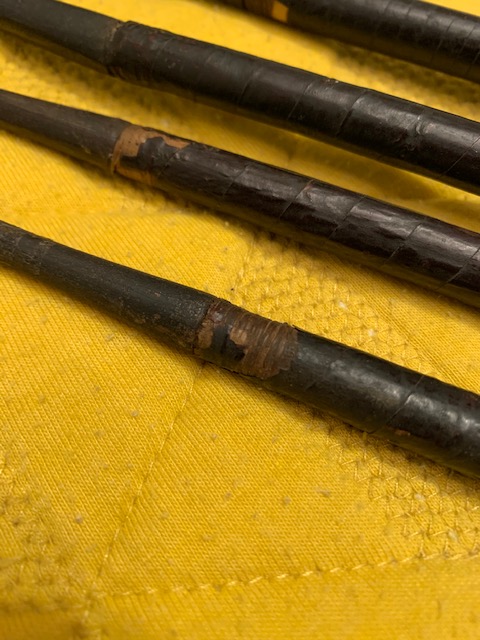

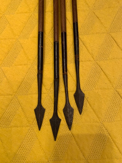

For the arrows that I am familiar with it is much the same as the spear. The images below show four Qing Dynasty war arrows (44in long, 1/2in diameter shaft, over 100g each). The Qing Dynasty was known for it's excellent archers. They shot these very heavy and robust arrows from extremely powerful bows. These four examples each show signs of being shot and are most likely trophy bring backs picked from the field during the first opium war (1842 ish). They are still in excellent condition even today which is likely because of their construction. Just behind the head, the shaft is wrapped with peach bark but under that is a wrap of sinew (in the last picture you can see the sinew peaking through in an area where the bark has pealed off). Sinew is exceptionally strong and is serving the same purpose as the ferrules in the spears mentioned above. My guess is that without this wrap of sinew, none of these arrows would still have their point. I am not aware of any historical tanged arrow type that does not also have some sort of circumferential strengthening of the shaft near the point. To make a long story short, all arrows that I am aware of are built to take a large amount of impact without damage, and I believe there is a functional reason for this. In order to effectively deliver the energy stored in the moving arrow, the arrow must stay in line upon impact. If there is any breaking or buckling of the arrow it would dissipate a large amount of the energy and the penetration would suffer greatly.

I think you hit the nail on the head here. I have forged both types of points, and the tanged point is definitely easier to make, but I think it would be far more difficult to mount. For socketed arrows you simply have to sharpen the end of the shaft and glue it into the socket, but for the tang you need to drill or split the shaft, mount the point, and then reinforce and glue the shaft. Perhaps it is just a case of trade-offs between the two during manufacture. I also think your point about refit of socket arrows could be valid especially if on campaign.
Regarding the weight I don't think that socketed points are by default heavier. The points on the war arrows below are very heavy and there is easily enough material there to make a socket. On the other end of the spectrum I have seen some very small socketed points. My guess is that the weight of either type could be tailored to the type and size of arrow without problem.

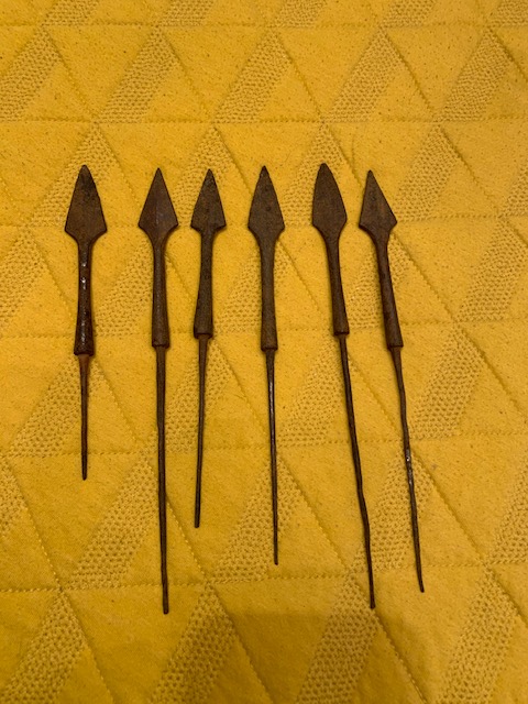

Just noticed when I posted that the Qing arrows almost look socketed. To clarify, here is what the points look like when they are not mounted.

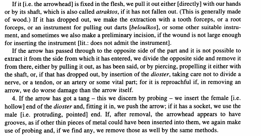

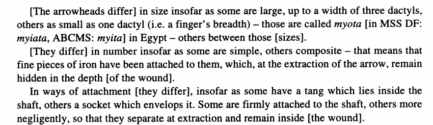

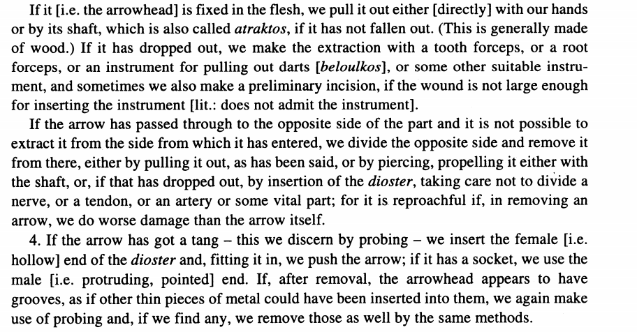

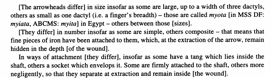

I might be mistaken but I often get the impression period war arrows weren't necessarily meant to rapidly cause death by bleeding out but rather aimed to wound and impede enemies by sticking in them and being hard to remove.
A socketed arrow and an arrow with a tang actually seem to require different medical tools to extract them successfully. Paul of Aegina briefly mentions this.

Tyler C.
Location: Canada
Joined: 20 Aug 2019
Posts: 166
PostPosted: Tue 15 Sep, 2020 7:43 am    Post subject:         Reply with quote
Good point Wink . I have read that the points on English arrows were only lightly glued so they may fall off on penetration (not sure where this came from though or how much evidence there is to support it). The Manchu arrows above were definitely made to keep the head intact. They have a wrap of sinew on the tang itself which I believe is placed on before the tang is inserted in the drilled and split shaft so that when the split is closed and tightly wrapped with sinew on the outside there is no way to remove the tang without destroying the whole end of the shaft.
