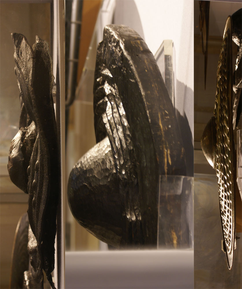

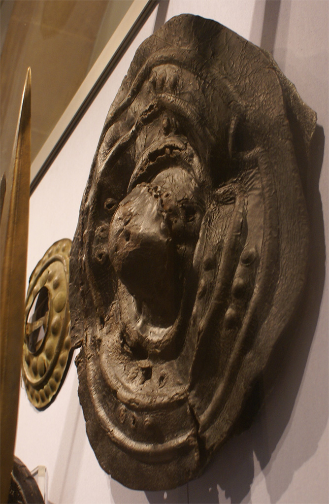

I've attached some photo's from:
- The display at the National Museum of Ireland
- The Clonbrin leather shield
- The Cloonlara shield mould
It's a great museum for anyone interested in weapons, and in bronze age weapons in particular.
 Attachment: 182.05 KB
 Attachment: 227.33 KB
 Attachment: 192.98 KB

Oh, neat, there it is! The object at lower center, from Cloonlara, is not a mold but a shield itself, made from a single slab of wood. Here's mine:
http://www.larp.com/hoplite/Cloon10.jpg
And here's Steve Peffley's Clonbrin shield, cuz it's purty:
http://www.larp.com/hoplite/Pefshld1.jpg

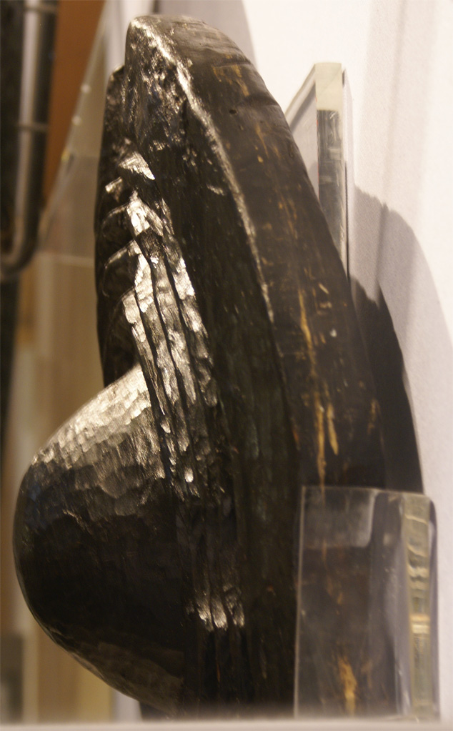

Paul Hansen
Location: The Netherlands
Joined: 17 Mar 2005
Likes: 5 pages
Posts: 845
PostPosted: Wed 07 Dec, 2011 12:24 pm    Post subject:         Reply with quote
Hmm, the museum clearly lists it as a mould... There must be some different opinions on it...
To me, the mould theory made sense: the thing is quite thick, at least several centimeters, and therefore must be quite heavy, unlike the bronze and leather shields. It's also quite crudely finished, which is unusual for bronze age weaponry.
I've attached a side view of the Cloonlara "item".
 Attachment: 177.6 KB
Gregory J. Liebau
Location: Dinuba, CA
Joined: 27 Nov 2004
Posts: 669
PostPosted: Wed 07 Dec, 2011 12:48 pm    Post subject:         Reply with quote
I think the real trick to knowing whether it's a mold or not would be to know what the back side looks like. There would be no need to hollow it out if it was a mold meant to be pressed against from the front. If the umbo is hollowed, it's far more likely to have been meant as a functional shield.

I'm pretty sure that press is described in Waterer's "Leather and the Warrior". It likely had a positive that mated to it to produce shields more efficiently. Its not like they had tacks to hold the leather in place as it dried. Wood pegs would have been recognizable in the surface.
Not really my area though, I think the article Christian linked above is the best discussion I've seen on this topic.
Oh, another neat photo! I hadn't seen the tool marks so clearly before. Rats, I made mine too nice! Mine is indeed heavy, but it is apparently ash while the original is alder, a much lighter wood. Plus mine may be too thick, at least a little. So I suspect the original is manageable, as a shield. (But boy, plant this sucker in someone's face and he's going DOWN!)
If they are thinking that this is a "positive" form or half of a press, I suppose that's possible. It does have a hollow boss and a handle,
http://www.larp.com/hoplite/Cloon11.jpg
But I really think the boss is too tall for it to be a mold for leather--that's really a LOT deeper than the boss on the Clonbrin shield, and as I understand it just dishing out the leather that deep was a challenge. The crudeness doesn't bother me, either it was simply a cheap shield (and I've seen a surviving axe handle that still had bark on it!), or perhaps it was intended as a votive from the start, which would explain the weight as well. The other surviving wooden shield is much nicer, and apparently thinner, too.
I haven't seen details on the Churchfield mold, just that one drawing, but I suspect it is flat on the bottom, with the cavity for the boss simply cut into the thickness of the wood--no raised boss on the "front", in other words. And both Neil Burridge and Steve Peffley made their leather shields simply by pounding wet leather into the "female" mold, without a "male" half, and got very realistic results. I think using a 2 part mold would need some SERIOUS force, like a battering ram! One guy with a mallet makes more sense.
Oh, I hardened a leather boss on my Sardinian shield just by pouring hot water over it. Seems to work, though I haven't done any testing. A light coat of wax over that would keep it from getting soggy in the rain without really "lubricating" weapons, I should think. I haven't seen any analysis of the Clonbrin shield that suggested it was waxed at all, but I don't know if they tested for it (probably not!). Don't know if wax would survive in a bog, in any case.
Matthew

Hi Matthew, the boss on the Clonbrin shield is pretty much exactly as high as on the Cloonlara shield. I remember seeing it from the side in the museum, and was surprised at how high the boss was sticking out. That doesn't show in any of the pictures have. The boss is also a separate piece, which as been stitched on. I've read mentions that it may have been a repair, but it could also just be to enable such a high boss, which would be very difficult if making the shield from a single piece.
Huh! Okay, that's interesting! Not sure *I'd* want to try stretching it out that deeply, but once again the ancients can always do it better than we can (grumble....). But I'd still say it's better and MUCH more easily done by dishing into a female mold with a mallet.
Oh, I thought I read that what we are seeing is a cap, basically, a second layer over the top of the boss. I think that's in Coles' article, but I'd have to dig around to be sure.
I've attached a pic of both shields side by side. Happy
For good measure, I also included the bronze shield from Lough Gur (which I rotated upside down).
Johan Gemvik wrote:
This is true for single combat or duels, perhaps even skirmishes, but not for wartime line battle where you have to take on a charging mass of enemies and stand fast. Then you have to have a stout shield that can take some serious damage when braced for impact. You do that with centergrips too, not just strapped shields.
Of course even a flimsy shield is still better than no shield and a lightweight small leather shield can be carried around effortlessly all day and these could be meant only for single fights and skirmish use and be plenty useful for deflection and voiding attacks. There were wood and all metal shields around after all, probably for the other heavier use..
But the exact nature of bronze age warfare remains a question. If you look at the Ilias, much of it seems to be fact single combat rather than shield wall combat. From Roman sources we know that the Celts also preferred individual bravery to formation fighting.
Neither says much about the North-west European bronze age, but the idea of warriors with light and fast swords and light and fast shields makes me think of a rather individualistic kind of warfare.
 Attachment: 133.51 KB
