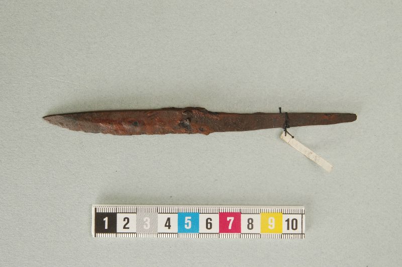

Hi Joshua, this is a great question.
I haven't seen the complete viking Helle knife with handle, sceath and all, but I own one of the bare blades they sell under the same name. I think it's pretty neat as it is, though I plan to re-grind it into a different type of viking knife for one of my odd projects.
Any number of modern carbon steel knife blades can of course be historicalized (did I just make that up?Wink ) to look fully viking authentic. I've done it with some blades in the past to good effect so they look like the archaeological finds. Most have triangular cross section, so one needs a thick blade to grind them out from, but not all of them.
With the extra thick blade of the Helle Viking it would be suitable to conversion into most of the Swedish knife finds from iron and viking age. But if you're lazy, just use it to build a replica of the find it's most likely based on, State Historical museum item # 416011 dated to betweeen 550 - 799 AD.
A photo of the find from Kringla.nu:
Link to the object in the Krningla.nu database (sorry, swedish only):
http://www.kringla.nu/kringla/objekt?text=vik...ect/416011
Link to the museum database (partially translated to English):
http://translate.google.com/translate?hl=en&a...11&g=1
Note that this find has flat sides, just like most modern day fixed blade utility knives and is about the same size though a bit on the thick side.
The Helle knife blade replica seems to me to match the original quite closely, but has some minor details I'd change on it to make it picture perfect. You need to trim a little off the hump on the back to make it smoother, the edge grind is ended with a sharp corner rather than the originals rounded off end of edge and it has a makers mark stamped on the left side of the blade that you might want to remove if you're picky. Most won't even notice it since the blade's oil burnt dust black though. The tang is also less wide compared to the find, but no one will see that when it's fitted to a handle. None of this really needs to be fixed even for re-enactment standard, only for museum level photo perfect replicas.
