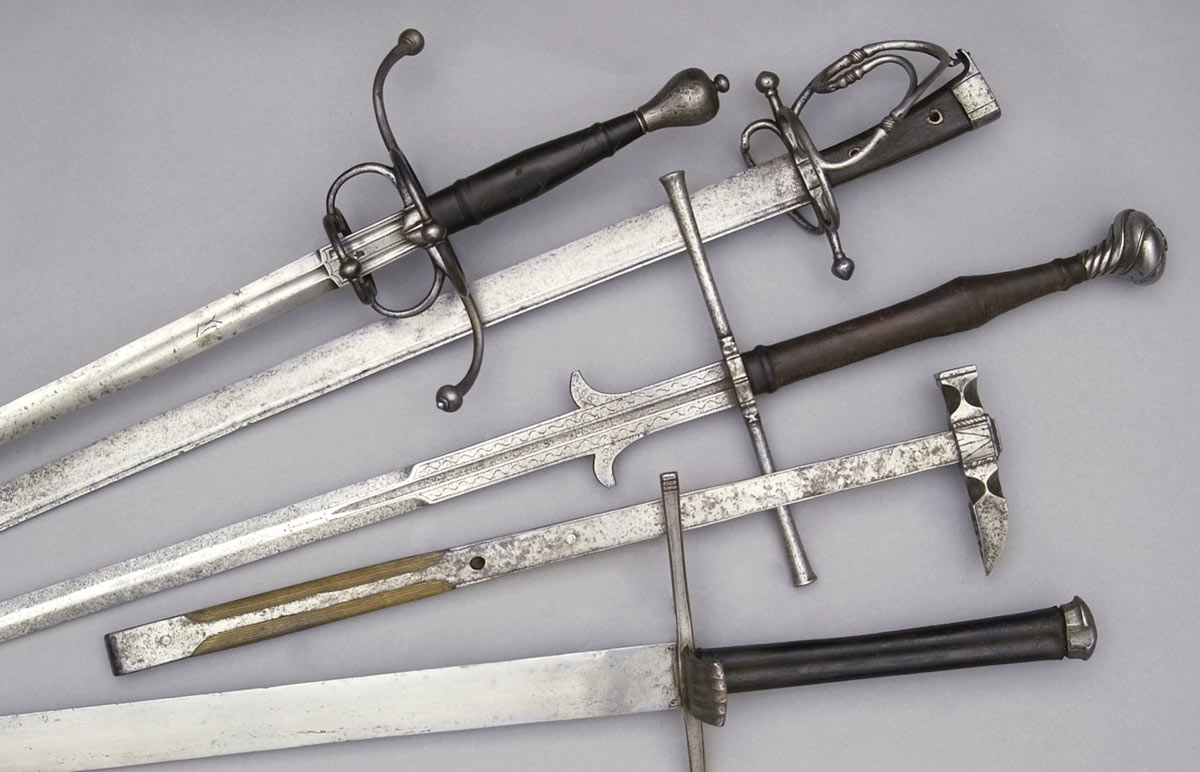

Posted: Tue 05 Jul, 2011 1:47 pm Post subject: |
In your position, I would simply mount it in a manner that would be visually indistinguishable from these historical examples and require no serious modification of your tang. Looking at the sword in question, I can't imagine why you'd need MORE grip, but I routinely create more grip by turning the upper part of the blade into as much extra tang as required. Cutting in the appropriate places is a very easy and fast process but it does require a blade long enough not to suffer aesthetically from that shortening. Since there's so little weight in the hilt of these weapons, shortening the blade is likely to improve balance. But, again, that Paul Chen sword looks like it's ready to be transformed into a saber like the one shown at a man's side below. If anything, it might need less grip. It's a very interesting project and one I'll be watching closely as I've wanted to undertake a similar project for several years. This could be a fun project if the blade is good!

Einar Drønnesund
Posted: Wed 06 Jul, 2011 8:48 am Post subject: |
Sean, that pic you posted is the very picture that inspired me to go the messer route with the Sentinel in the first place.
As for the tang, it doesnt go all the way through that extremely long grip, and for my taste, the grip was too long anyway at about 16". The tang is 10" long, and its first and foremost the width, not the length, I wanted to increase, so I could do the grip slats like on a proper messer. However, the framed handle solution will take care of that without risking messing up the heat treatment by welding on it.
