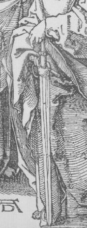

Hi all,

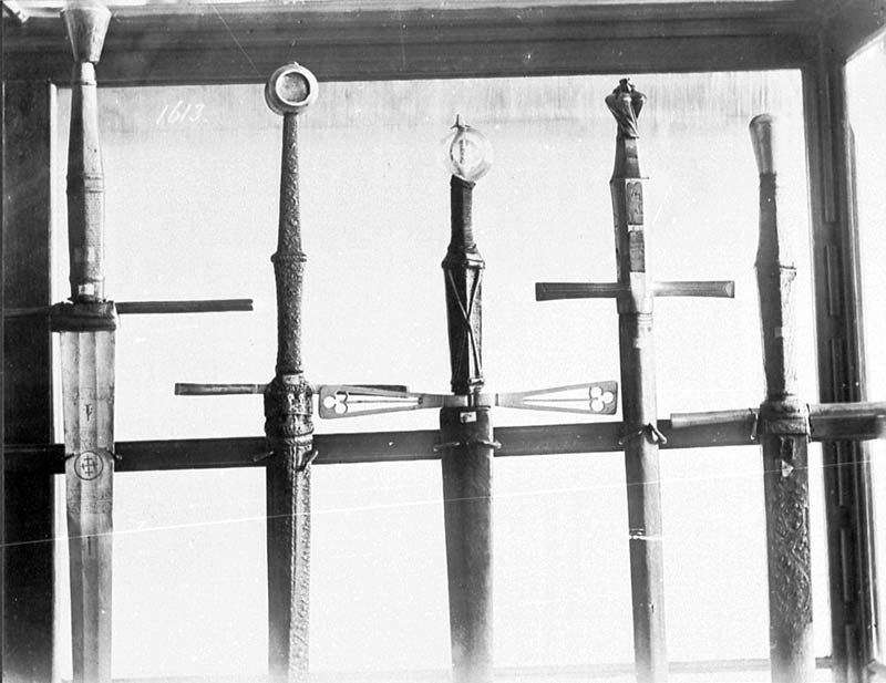

I have the great good fortune of having a slot soon in Brian Kunz's scabbard schedule, for not one but two Albions - an Earl and a Munich - and am looking for period examples of late 15th / early 16th C scabbard design details for inspiration.
Now, before someone says 'we have lots of threads on scabbards here', I'm after images of actual scabbards, or images in period art, that show the detail of design: tooling, risers, chapes, and so on. I've looked at many threads here, but couldn't find many images that show these details.
While we have some wonderful threads here about suspension designs, and 'rainguards'/chappes which show a lot of detail, I'm not sure we have much on scabbard design as such. (Interestingly, many of the period images we have that show great detail of 'rainguards'/chappes don't give much detail of their partnered scabbards.)
We do have some great images of messer scabbards, such as the 'messer scabbard pictures?' thread, and the Knecht thread ... these images have more detail of scabbard design than most that I've seen here for longsword scabbards.

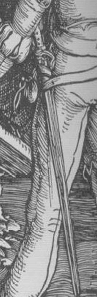

I'm going to kick this off with some images of actual scabbards that have appeared here before, as well as the best detail I can get of Dürer's 'Knight, Death, and the Devil' ... when seen on a good print, three things are apparent:
- the longitudinal riser (as seen in other Dürer images)
- the very long chape
- and what appears to be a chevron design, with the points facing downwards ... on a good print, this very much looks to me like detailed chevrons, and not simply artistic hatching ... and is interesting, as in the two images I have of the Bayerisches scabbard, there seems to be a hint of a chevron design, with the points facing upwards ...
To me, this fairly lineal design is an interesting contrast to the more sinuous designs that Brian is fond of (and so very good at), and which are mirrored in the scabbard at the end of the row that contains the Bayerishces, below.
Anyway, to questions:
- Do you have any images that show good detail of late 15th / early 16th C scabbards - risers, tooling, chapes?
- What suggestions would you have for me/Brian for the Earl, and the Munich - and why? (At this point, I'm tempted for chevrons for the Munich, to match what appears to be the design on the Bayerisches, as well as in Dürer; and then let Brian 'have at it' with a sinuous design for the Earl, which has a similar grip and pommel to the 'other' Bayerisches sword shown at the right of the racked collection.)
- Colours: Peter Johnsson let me know that the grip and scabbard colour on the original Bayerisches was a very dark brown. Mine is now black; do we have images of black grips with brown scabbards? Alternatively, my Earl's grip is oxblood; sinuous lines seem to work best on scabbards Brian has done in various shades of brown ... do we have examples of an oxblood grip and brown scabbard in period art? Would it look odd? On the other hand, would sinous lines work on an oxblood, or black, scabbard?
Thoughts? Images? Inspirations? Suggestions?
 Attachment: 29.53 KB
 Attachment: 57.63 KB
 Attachment: 21.68 KB
 Attachment: 232.8 KB
 Attachment: 249.21 KB
Dürer scabbard detail - note long chape, longitudinal riser, and chevrons

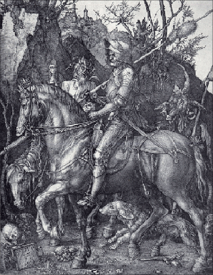

PostPosted: Wed 21 Dec, 2011 11:41 pm    Post subject:         Reply with quote
This is detail from Dürer's Das Große Pferd (1505) - this one clearly shows an impressed outline of a sword shape / border that follows the line of the scabbard:
 Attachment: 22.39 KB

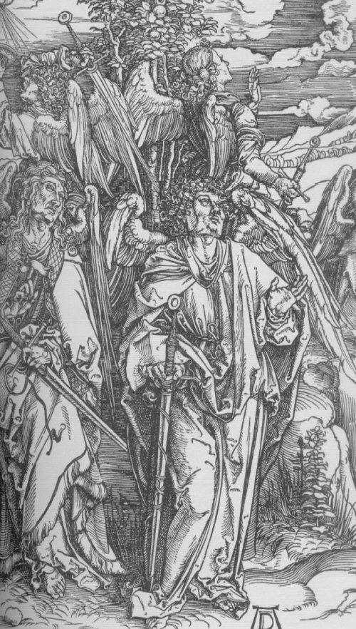

Mark T
PostPosted: Thu 22 Dec, 2011 12:06 am    Post subject:         Reply with quote
Dürer's Die vier Windengel und die Versiegelung der Auserwählten (1497/98) also clearly shows risers. The image below loses a critical detail of the original - the longitudinal riser is shown in both swords as having a dedicated thickness. (This means there's no confusion about it instead simply being a line caused by a change in plane of the scabbard's diamond cross-section.) This detail can be more clearly seen in the reproduction in Albrecht Dürer: Waffen und Rüstungen, Heinrich Müller (Berlin, Destschen Historischen Museum, 2002).
 Attachment: 191.07 KB

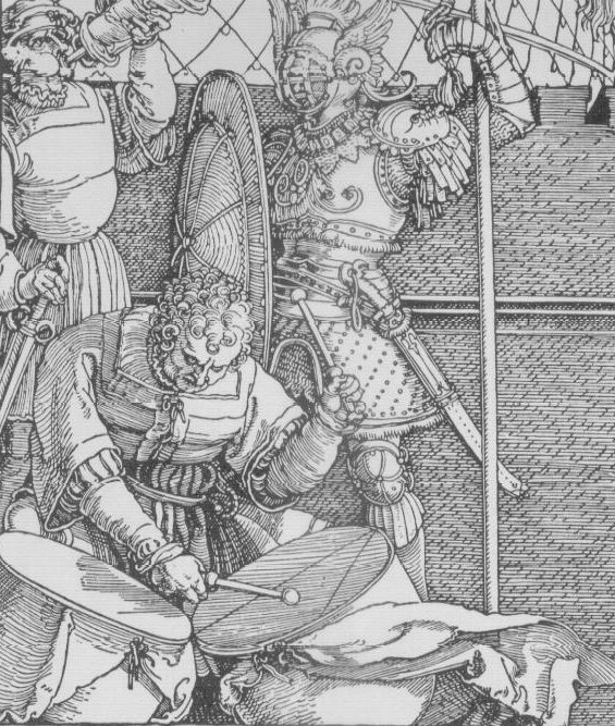

Mark T
PostPosted: Thu 22 Dec, 2011 12:22 am    Post subject:         Reply with quote
This scabbard in Dürer's Die Schaustellung Christi (1498) from The Great Passion, shows a longitudinal riser, clear border around edge of the scabbard face, tooling/decoration of the panels between the riser and border ... and what looks like a very, very long chape (again, see Albrecht Dürer: Waffen und Rüstungen for better detail.)
 Attachment: 142.76 KB

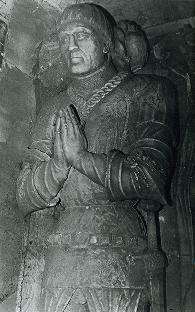

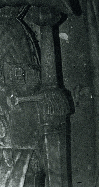

In the meantime, here's an effigy, reproduced from Turnbull's The book of the medieval knight (London: Arms and Armour Press, 1995):
Monumental effigy of Lionel, Lord Welles, a Lancastrian knight who was killed at the Battle of Towton in 1461. His body was conveyed in secret to this tomb in Methley, West Yorkshire. The sculpture is very striking, showing clearly the fashionable hairstyle of the period, and is very detailed in its representation of a contemporary style of armour.
This scabbard shows a diamond-section scabbard, with clear change of plane in the faces, rather than the use of a longitudinal riser. It also has two horizontal risers in bands just below the 'rainguard' / chappe.
 Attachment: 249.19 KB
 Attachment: 229.02 KB
Detail
