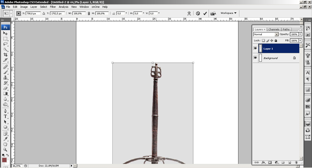

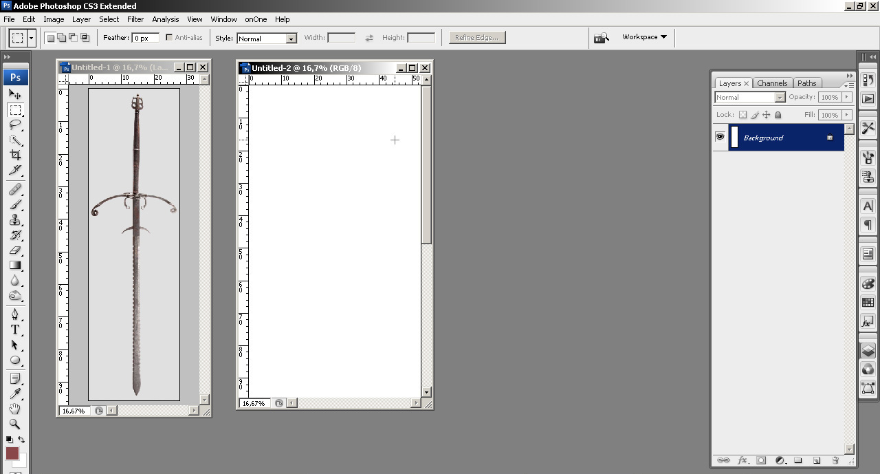

I see. Well your idea of a "hybrid", to me, makes sense because i am not a tall fellow as well and my two-hander handles precisely like the hybrid you described. Now, about your project if you are being so careful and cautious i think would be good if you could make a sword as close to the original as possible. With the proportions of the original. You can always make another sword with a little more room for customization. Or, you can use this project as a trial. For i can assure you that you going to find many minor mistakes and things you could' and should have done better. I agree when you say that a bigger handle would be more balanced for you because this is what happens to me. I have made a longer grip and that was very wise. Now, for the proportions I have worked out a method to obtain the almost exact proportions and size of a sword. If you have the full lenght measurement you can do the same thing i do. First you must open the image of the original sword with Photoshop. Next you open a new document. Next you will resize it's length to the same length of the sword in question (the program will make the right proportion to the width). Then you go to the original picture and remove all the parts that are beyond the ends oh the blade, the pommel and the "quillons". Now, you copy and paste the original to the new image with the same lenght as the sword. You press control + t. A frame will appear. Click on the corner and, pressing and holding "shift" drag the corners of the frame until it matchs the upper and lower borders (dont worry about the width for now). Select the "crop" tool and adjust the borders to fit precisely with the sword's top, sides and bottom limits. Press "enter". Now you have a big image, in actual size ready to be printed and many proportions to study. I believe that will give you a very good notion about proportion (very close to the original). But the measurements must be absolutely precise. I will send a visual tutorial of the process and i hope that helps.
Take care.
 Attachment: 165.9 KB
Now top and bottom match. Remove the excess backgroundm save and print. [ Download ]
 Attachment: 171.86 KB
A frame will appear. U need to match top and bottom borders with background's top and bottom. Dont forget to press shift all the time you drag the frame's corners. [ Download ]
 Attachment: 158.32 KB
Now you can see the sizes are quite different. What you gonna do next is to press control + t. [ Download ]
 Attachment: 177.62 KB
Note that the excess background has been removed. Now you copy this image and paste it to the new resized document. [ Download ]
 Attachment: 172.41 KB
These are the original sword image and the new document. The background of the sword's image is bigger. Resize the new document to match the sword's actual length. [ Download ]
