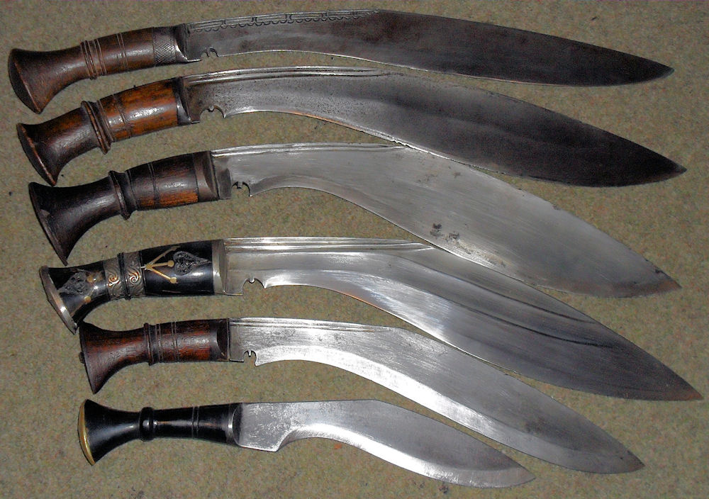

Hi Glen,
Certainly not a myth.
Each form of Kaudi doubtless has a special meaning. It is said that many are based on various styles of temple roof.
Occasionally you will even see one where it's design is so elaborate that it purpose is surely compromised.
However, the practical reason for the Kaudi IS to help direct blood/water/sap flow away from the hilt and it's stylistic development of varied significance is separate.
A favoured attack is an upward stab to the guts causing the victim to double-over. The attacker would then wrench the Kukri free and behead the target with a single downward slash to the back of the doubled-over persons neck.
Various aspects of the Kukri form would (despite the lack of guard) help to direct the flow of liquid away from the hand.
Here are some examples of Kaudi:

Gene W
Location: The South Of England
Joined: 01 Dec 2010
Posts: 116
PostPosted: Thu 08 Sep, 2011 12:36 pm    Post subject:         Reply with quote
[quote="Jeffrey Faulk"]
Glen A Cleeton wrote:
Hi Gene
I believe that this is in fact the original reason the 'cho' notch was made. Explanations vary from being a sort of, ahem, representation of divine... parts, to a metaphorical cow's hoofprint.
I imagine that both those and other designs are represented, along with many others.
It might be easier to visualise the practical purpose with some pics of the whole items.
Interestingly I only have one without a Kaudi, and it would have been made for a western military owner: air crew or tank crew.

How does this fit with the Chitlange/Chainpure types where the bit in question is a hole in the blade?
Regards
Geoff
Gene W
Joined: 01 Dec 2010
Posts: 116
PostPosted: Fri 09 Sep, 2011 2:20 pm    Post subject:         Reply with quote
Regards
Geoff
As I say, some types clearly compromise the purpose.
Often though, there is some effort to direct the flow, even when the Kaudi is a 'closed' type.
Best
Gene
