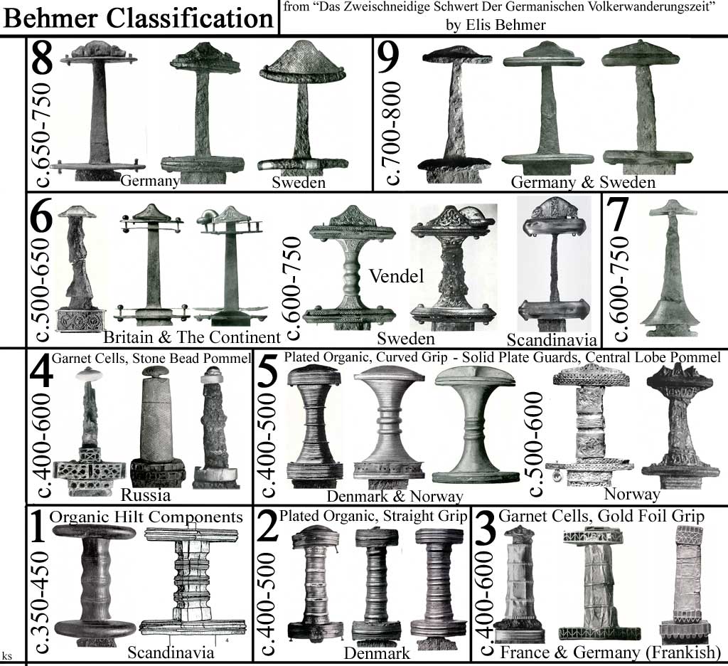

I forget where this picture comes from originally, but here are some early pommel examples covering the period being discussed.
 Attachment: 79.05 KB

They are, but if you find a large bead with a hole in the centre (or any other piece of fitting) right next to a sword, there are a couple of ways to interpret that.
In Behmer's time, the common interpretation was that they were pommels, currently the common interpretation seems to be that the exact same pieces were sword beads...
Looks like a combination of pictures from Behmer's book.[/img]
IIRC this was put together by Kirk Spencer
Éirinn go Brách

Stephen Curtin wrote:
Probably. Kirk posts some of the best pictures.
That particular picture shows a nice progression of Migration Period pommels. I don't think it's nearly that clear cut in the archeological record, but it works for the picture.

That is an image I put together many moons ago of loose pommel caps published throughout Elis Behmer's "Das Zweischneidige Schwert Der Germanischen Volkerwanderungszeit”
I tried to group similar types of pommel caps together... however I did not intend a progression. However, now that I see it again, the tiny peening block in the upper left corner may imply a development. However the small peen blocks or plates appear off and on anytime the tang is being peened over an organic material. A thousand years before the Hallstatt swordsmiths used such circular peen blocks to peen the end of the pommel spike on Bronze Swords. I posted a picture of these in this thread.
http://www.myArmoury.com/talk/viewtopic.php?t...p;start=20
The pommel caps are not developing in isolation but as part of a complete package with the rest of the hilt. In terms of design the most likely candidate to me is in Behmer's type V (5). I have read somewhere that this type has bee found with where the tang goes through the upperguard and dome shaped cap and peens on the outside. Then they are peened at the top of the upper guard and the dome shaped cap is glued or riveted to the upper guard. At this point it would be a "cap." If you look at the progression in the type V (5) as they are presented on the attached chart you can see my attempt to put them in the correct sequence of development, however, as someone said, there is little archeological evidence of this sequence... it is more of a design conception.
