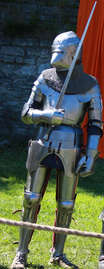

I don't think you would find anything usable in the 150$ range. Just what Josh said except one thing: most gauntlets you would find in this price range would most likely be TOO THICK and heavy.
If you want to use the gauntlets for serious sparring I would advise to look for "half-mitten" style where finger tips are covered by individual small lames. This picture of me would hopefully explain what I mean:
You can see large plates covering the most often-hit area and the rest part of the fingers is protected by small plates as on normal fingered gauntlet. Another thing to pay attention to is the thumb. The best is when plate protecting tip of the thumb lies against plates protecting the fingers so that force of the blow is transferred into these plates instead of the thumb. This is especially important for mitten gauntlets. However such thumb construction makes putting your thumb on the flat of the blade rather uncomfortable (not to mention the fact that on some types of gauntlets thumb simply cannot be placed on the flat of the blade, after all armored and unarmored fighting are very different stuff).
Gauntlets should be LIGHT. I use 1 mm (it is approx. 18 ga I think) for most plates . I use thicker steel only for often-hit pieces such as knuckle plates or plates that protect tip of the thumb. After all you should avoid getting hit in the hand when possible, authentic gauntlets seem to have had no padding so getting hit was still pretty painful and in case of fingered gauntlets it was relatively easy to break a finger. For reference, right gauntlet from the picture weighs 650 g (less than 1.5 lbs) including padding and leather glove. Left one is even lighter because it does not get hit that often. Both gauntlets offer very good protection, even getting hit in the fingertips doesn't hurt very much. If I get a strong blow for example in the cuff I would have to straighten it, but I haven't had to do it for the last two or three years. Thicker steel can be used for gauntlets if you want to never ever repair them or if you plan to fight full-force with polearms or maces. Well, if you plan to do free sparring with polearms I would advise you to get mitten gauntlets with fingers covered by at least 16 ga steel.
If you still want to go for cheap gauntlets buy the shortest ones (hourglass that is). Most makers use one steel for all parts so long-cuffed gothic gauntlets entirely made of 16 ga steel would weigh a ton but hourglass gauntlets made of same steel would still be reasonably light. Gothic gauntlets entirely made of 18 ga steel would probably require straightening too often so are also not a very good alternative.

For fingered gauntlets it is true, but for mittens and half-mittens it is not. Small plates of fingered gauntlets don't benefit from being thick, but finger plates of mitten gauntlets receive most of the hits and get deformed pretty badly if are made of thin steel.
The most often hit areas are fingers (actually knuckles) and thumb. It usually happens when you deflect blows incorrectly and put your hand in the path of the incoming blow instead of your blade but also when somebody aims at your hand. Next is metacarpal plate, it usually happens when somebody intentionally aims at your hand, but in this case blows usually come either from the top ("crossguard side") or bottom ("pommel side"), not from the back of the hand (which is most of the metacarpal plate area, fluted in case of gothic gauntlets). Cuff gets hit least often. Also it stays away from your hand due to its flare, disperses some of the blow energy by freely moving around and in case of full arm protection overlaps with vambrace. If you can do some basic armor repair (that is straightening) 1 mm is perfectly OK for cuffs and 1.2 mm for the back of the hand if knuckles are protected by a separate plate made of thicker steel. For finger protection I recommend 1 mm for fingered gauntlets and 1.5 mm for mitten gauntlets.If you can't do any armor repair... Don't fight in armor, or it will anyway need repair at some point.
