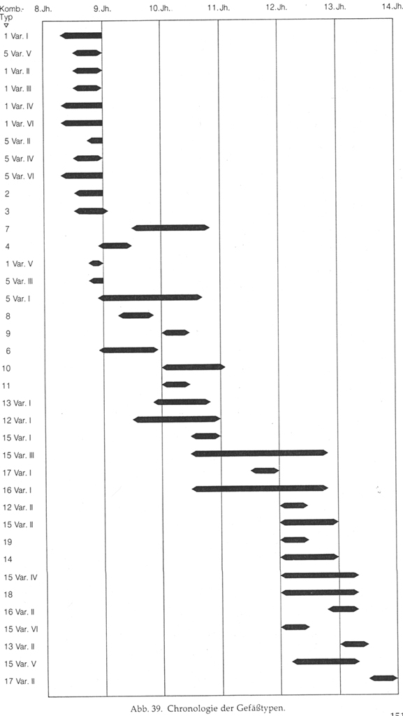

Paul Hansen
Posted: Thu 23 Jun, 2011 1:06 pm Post subject: |
Attached you'll find a scan of Geibig page 151 with an overview of his hilt types with chronology.
Two pages further, there is an overview of his blade types with chronology, so I've attached that one as well.
Because his work is very, very thorough, it is not so easy to fully grasp. And I must admit to not really having had the time to really go into depth with it.
Both images copyright Alfred Geibig / Karl Wachholz Verlag, 1991. I hope it's ok to post them here, in an unaltered state. Otherwise, please let me know, then I'll delete them.
Attachment: 126.78 KB
Attachment: 112.61 KB
J.D. Crawford
Posted: Thu 23 Jun, 2011 2:56 pm Post subject: |
Thanks for the images. If I'm reading this right, he puts his type 12 pommel (similar to Oakeshott's B) from 950-1100, and type 15 (similar to Oakeshott's A) from 1050-1275. Right? That sounds right to me.

Luka Borscak
Posted: Mon 27 Jun, 2011 5:06 pm Post subject: |
J.D. Crawford wrote: | Thanks for the images. If I'm reading this right, he puts his type 12 pommel (similar to Oakeshott's B) from 950-1100, and type 15 (similar to Oakeshott's A) from 1050-1275. Right? That sounds right to me. |
I interpreted it as 950-1175, if the first column is 8th century, and last one is 13th century...
Btw, Paul, could you maybe post a picture of pommel types? In the myArmoury article is obviously a shortened version and not all variants are pictured...
Kirk Lee Spencer
Posted: Mon 27 Jun, 2011 8:46 pm Post subject: |
Luka Borscak wrote: | J.D. Crawford wrote: | Thanks for the images. If I'm reading this right, he puts his type 12 pommel (similar to Oakeshott's B) from 950-1100, and type 15 (similar to Oakeshott's A) from 1050-1275. Right? That sounds right to me. |
...Btw, Paul, could you maybe post a picture of pommel types? In the myArmoury article is obviously a shortened version and not all variants are pictured... |
Hey Luka...
You may be interested in this thread...
http://www.myArmoury.com/talk/viewtopic.php?t=14152
Skip down to the Geibig charts. There are quite a few... and if you copy them all into a folder, sort by name then do a slide show, you can almost see the organic nature of how the pommel changes through time.
In each chart, I tried to combine as much info on assiciations of blade, pommel and guard in Geibig's data. Also the dates Geibig gives are in blue for each of the groups.
