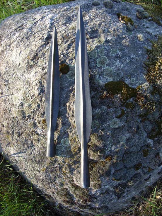

Hi Friends,
after a long time of not posting - here my new Black-Series of Lance heads. The big one is of the scandinavian Type Vennolum which is the Type 15 Lance head in the Illerup Bog in Denmark and it dates 200 A.D. It is 44,5 cm long. The smaller one dates to the early first century and was originally found in Harsefeld near Hamburg. I hope they all show the main characteristics of the most underrated weapon (and most under-prized )...
I hope I will find time to do a blued series with silver-inlays and a black with silver, too next months. I will post them when I got them done.
Hope you like them.....

Henrik Zoltan Toth
Posted: Sat 04 Jun, 2011 1:25 pm Post subject: |
Wow, those are really nice!! I like lanceheads.
I don"t know the correct english words, also, hast du die Lanzen ohne oder mit Gesenken geschmiedet? :-)))
Regards:
Zoltán

Gregg Sobocinski
Posted: Sat 04 Jun, 2011 7:02 pm Post subject: |
Those look fantastic. I really enjoy seeing well made, interesting spear and lance heads out there.
Thanks for sharing!
Peter Johnsson
Posted: Sat 04 Jun, 2011 11:39 pm Post subject: |
Very good work!
Beautiful creation of a beautiful type.
It makes sense to think that these were made in large numbers by specialized smiths, does it not?
(with the special dies and tools used)
Looking forward to see more.

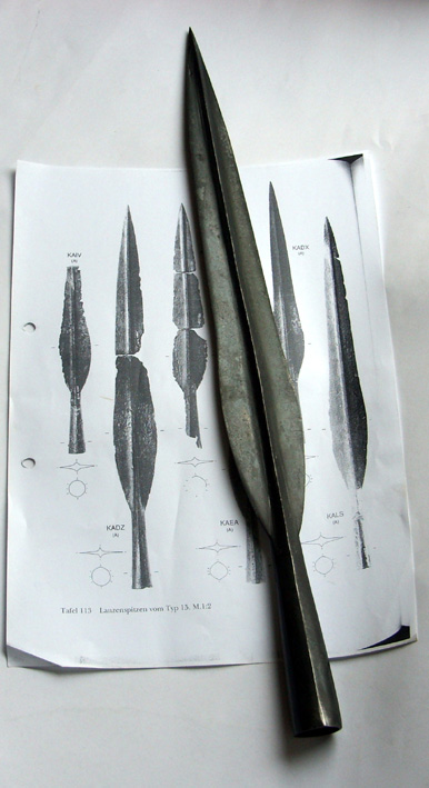

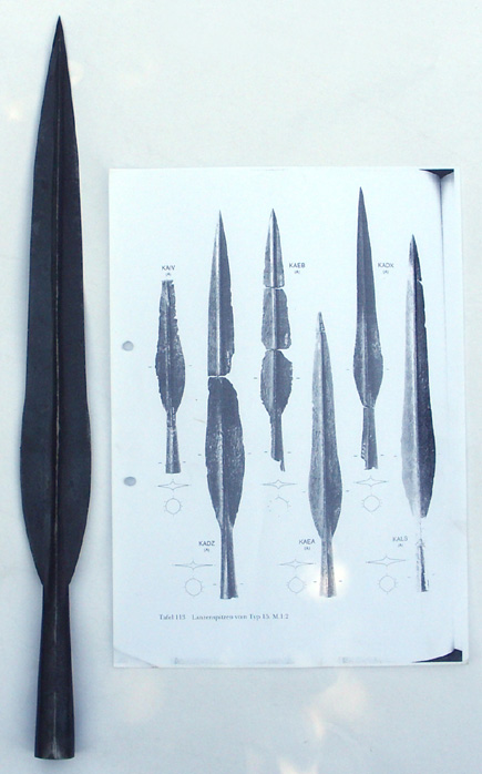

Christian Böhling
Posted: Mon 06 Jun, 2011 5:21 am Post subject: |
So we meet in our opinions about organization of weapon production and clearify, that ancient warfare was not just a personal act of heorism, but a political motivated act - maybe hidden in the unvisible backgroud when the outlines show personal motivated engagement like perspective of plundering or personal ranking ambitions....
I think Arne and Peter are right when they say, the political power was in the hand of people, who served in the roman army.
It is interesting, that nearly all despositions in the offer sites could have been an echo or a response of things happened the same time or close before at the roman border-line....
@Arne, yes I tried myself very hard like you to get those lances done, and I am still not finally satisfied, because I still do not meet the exact precision of the originals. But we are on our way to find out the exact right construction of punches and dies to reach this clone-like character of the original items
Thanks for your kind words about my work
Attachment: 126.86 KB
![LanzeIllerupTyp15MA1.jpg](files/lanzeilleruptyp15ma1_127.jpg)
Attachment: 127.73 KB
![LanzeIllerupTyp15MA2.jpg](files/lanzeilleruptyp15ma2_524.jpg)
better comparison of original and recreation
