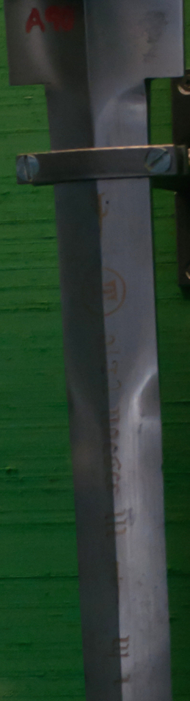

Shay, what are those markings on the blade? I can not quite make them out. It looks like 'A90' written in nail polish at the base, but below that are some other marks.

PostPosted: Wed 01 Jun, 2011 8:48 am    Post subject:         Reply with quote
The case was dimly lit and the markings were unfamiliar so I couldn't make sense of them. Also, they didn't allow flash photography. I've attached a close-up of the markings...
