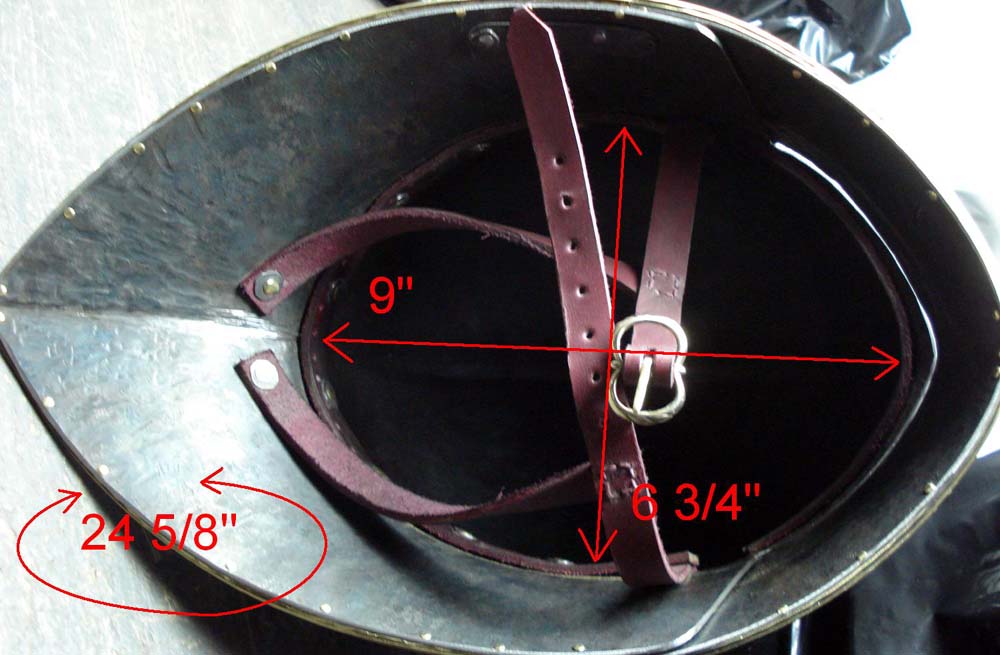

Hi Jason,
Without wanting to derail Philip's thread about spangen's too much, I'll just quickly attach an image here for download. It's from Francois L'Archeveque's site - rather than just the single strap that most modern sallets I've seen have (including five of Francois's other sallets for which I've seen his strapping), he has run a secondary strap from the back of the helm. This provides a better fit and more stability. IIRC, in a thread at The Armour Archive, he said he was shown this option by Robert MacPherson, and then Mac chimed in about it.
I find it interesting because a) of its functionality, b) it's uncommon in modern strapping methods, and c) that it provides another option for the paired rivets we see on the tails of some sallets - there was a thread at the Arms & Armour Forum a while back about what these might be. From memory, most of the participants proposed that they were for a small loop that could be used to hang the sallet (as seen on some modern examples, such as one I have by Stanislav Prosek). However, Mac and Francois's strapping option here would make those rivets serve a different function than what many were proposing in that AAF discussion. No reason you couldn't have both options on different sallets, of course ... just to confuse those of us coming along 500 years later and guessing at their use! :)

Sorry if I wasn't clear. I just happen to be working on a spangenhelm currently, and looking for a historical way to build it specifically. However, I would like to see pics of ANY type of non-buckle fastening...as I am starting to build later period helms and am always looking to expand away from the "typical".
Mark, that is a very functional design. I actually have strapped up a few helms with those "secondary" straps towards the rear. They definitely provides alot more stability on the head.
