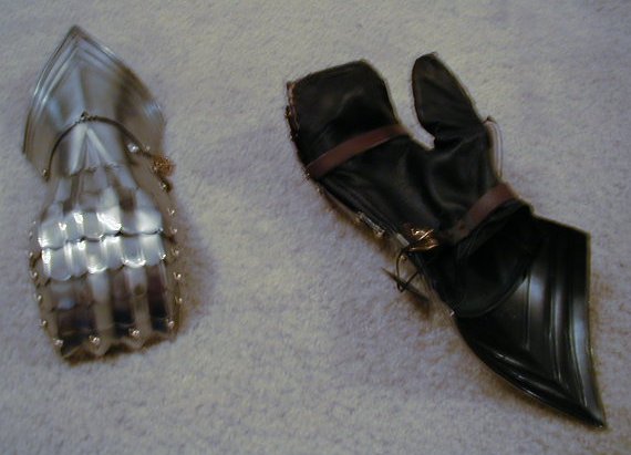

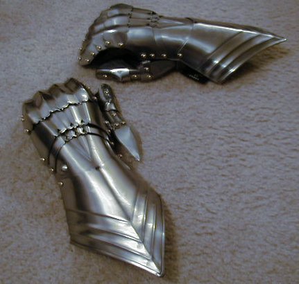

Just picked up a pair of MRL gothic mitten gauntlets for an excellent price. To my pleasant surprise, they look beautiful. They really are very well finished, and the piercings and fluting is very clean. They're even lined with a thin leather mitten inside that would accomadate many sizes of hands.
But, like so much of MRL's line, there is a definate reason that they are priced the way they are. The articulation, despite having five lames on the finger portion, is terrible. I can barely close my hand with these on. I certainly can't grasp a sword hilt well enough to feel secure in swinging it. Unless if there is some way to fix this (any ideas?), these will definately have to be immediately retired to the "decorative" bin.

PostPosted: Tue 14 Sep, 2004 8:18 pm    Post subject:         Reply with quote
You're right. They look quite nice. I'm curious, what was the price point?
I've found that articulation can often be helped by repeated use and bending of the pieces. Of course, it the patterns used to make the thing were completely hosed to begin with, nothing will help it.

PostPosted: Tue 14 Sep, 2004 8:24 pm    Post subject:         Reply with quote
They're normally $175. I managed to get mine for $100 through a friend of a friend (that sounds so shady when I say that. Cool ).
I did try to bend them a little, which slightly helps, but overall it's still not good enough. The holes where the lames are rivetted are not "slots", for the articulation to move around, but are simply holes just big enough for the rivets. I think the only way to fix this is to send it to an armourer to take apart and redo the slots, which I'm not sure is cost effective enough to justify. I may ask around, though.

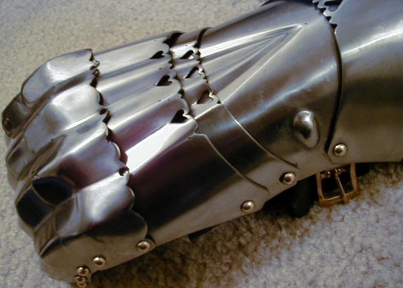

PostPosted: Tue 14 Sep, 2004 8:28 pm    Post subject:         Reply with quote
I really like the pierce work on these. They match the gothic cuirass that MRL also sells, a piece I've always been in love with aesthetically... but I've always been far too hesitant about functional issues to actually throw the money on. These gauntlets are a perfect example of why I'm not willing to risk it.

PostPosted: Wed 15 Sep, 2004 9:33 am    Post subject:         Reply with quote
Hi Bill,
Sorry you fell into this one too. One of our new guys just purchased these, with the same articulation problems. We checked them out and felt that altering them to resolve that issue would be almost impossible without creating aesthetic compromises. They are articulated with the plates overlapping each other too much, so the only way to fix that would be to take the things apart and re-rivet them with new holes. This would leave, in some place, the old holes still visible. At any rate, he sent them back ultimately.
It's a shame, because they are nice looking. But you can see in how the fluting on the back of the hand doesn't line up that they're very careless in articulating these things. And unfortunately, they're so tight that you can't count on simply breaking them in.

PostPosted: Wed 15 Sep, 2004 12:51 pm    Post subject:         Reply with quote
Hi Christian,
Actually, though it doesn't show in the angle of my picture, the fluting on mine does line up pretty well. Much better than what I've seen some American armorers do. Aesthetically I was very surprised with these. But if the ones you saw had flutes that didn't line up, that's a big sign of the common MRL quality control issues, unfortunately.
For the price I paid, having Gruber look into modifying these may be worth it, even if there's some tell-tale holes.
