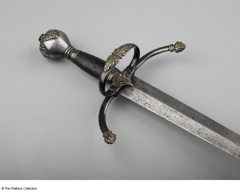

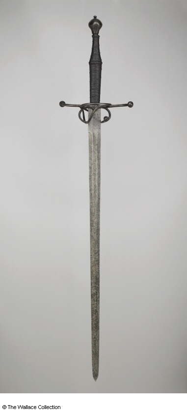

PostPosted: Fri 01 Apr, 2011 8:42 am    Post subject:         Reply with quote
Sean, do you have any more info ont this sword from the Wallace Collection?
http://www.myArmoury.com/talk/download.php?id=34194
PostPosted: Fri 01 Apr, 2011 8:46 am    Post subject:         Reply with quote
It's on the Wallace Collection web site.
The Wallace Collection wrote:
Sword
Unknown Artist / Maker
c. 1560 - c. 1580
Iron or steel, fish-skin and steel, chiselled
Length: 92.6 cm, blade
Width: 3.5 cm
Width: 1.105 cm
Maker's mark
A519
European Armoury II
PostPosted: Fri 01 Apr, 2011 8:48 am    Post subject:         Reply with quote
Sean, do you have any more info on this sword from the Wallace Collection?
It's a personal favorite!
# Sword
# Unknown Artist / Maker
# c. 1560 - c. 1580
# Iron or steel, fish-skin and steel, chiselled
# Length: 92.6 cm, blade
Width: 3.5 cm
Width: 1.105 cm
# Maker's mark
# A519
# European Armoury II
Direct link: http://wallacelive.wallacecollection.org/eMus...detailView
Wallace Collection Search Page: http://wallacelive.wallacecollection.org/eMus...=highlight
NOTE: You won't get every sword when you search for "sword". Try both "sword" and "longsword" in separate searches. It's probably a good idea to use a similar system when searching for other items ("helmet" and "sallet", for example).
