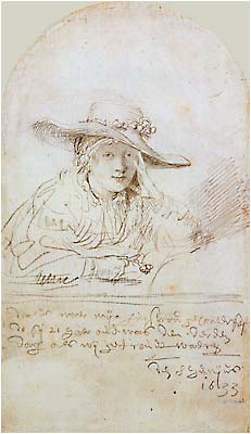

As I see it, it is not so much a matter of flaws being present in ancient work. It is rather about how good the work is.
You can have something that is "flawless" and still leave you with a feeling of emptiness.
On the other hand you can have something that is very rich and rewarding, that on closer inspection may not be perfectly symmetrical.
But that is beside the point. It is not about being symmetrical, or "perfect" in every detail. It is about being great.
See below two versions of beauty. Perhaps that is the best way I can express it.

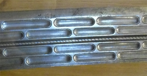

PostPosted: Sat 02 Apr, 2011 7:16 pm    Post subject:         Reply with quote
Swords made ​​of CNC are cold. Contrary to popular belief, perhaps 50% of the finishing work is manual.
Inevitably have flaws. Fortunately, this work by a manual imprint of the sword, takes a cold perfection.
The swords are a symbiosis of technique and art. The technique we can quantify.
A defect becomes good or bad, other than the sensitivity of the observer.
The art, by definition, not be defined.
P.S.
Above:
These slots in groups of different lengths, are in the depth of the frame and within a few tenths of a millimeter.
It seems that those who made this sword, had an idea of perfection out of the ordinary

Our ancestors relied on real swords to keep them alive and to do harm to their enemies. An asymmetry was the least of their worries. Not that they didn't care about looks. But because the sword was first and foremost a weapon/tool and because they lived in an era when symmetry was harder to achieve across the manufacturing spectrum, they seem to have been more willing to put up with these issues than we often are.
Disclaimer: I'm talking about real battlefield weapons, not ceremonial weapons or training pieces.
