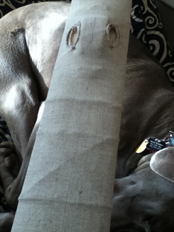

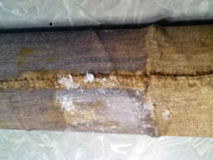

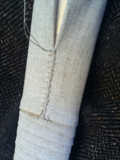

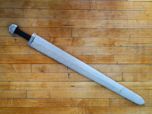

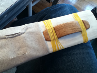

I'm having a blast trying to figure out how linen scabbards were assembled in the good old days. I read a previously-posted threat about a linen scabbard an am currently bouncing emails back and forth with Johan Gemvik as he is working on one as well. I have some questions and maybe you all might be able to provide some thoughts.
1. Is the X-shaped bracing both structural and symbolic, or just one and not the other?
2. Should the X-ties and diagonal cord wrapping be applied before directly to the wood for more secure bracing, or is applied on top of the linen to assist in keeping the linen tightly wrapped?
3. Illustrations don't show a belt slider, but it may be hidden under the linen wrap. That works, but it exposes the underlying wood to moisture or whatever else may creep into the opening.
4. What is the finished scabbard coated with for protection? The hide-glue would likely come undone in the rain and beeswax gets gooey with handling in hot weather.
In keeping with the tradition of experimental archaeology, I tried the cross-bracing under the linen this morning, and I sewed up the seam rather than wrap & overlap. I also cut holes for access to the belt slider. The sewing worked great and was much cleaner than my earlier attempt at wrapping the scabbard with hide-glue-soaked linen. With a snug-fitting sewn cover, it wouldn't be too hard to rub on the hide glue since it penetrates quickly.
 Attachment: 84.91 KB
 Attachment: 94.03 KB
 Attachment: 89.04 KB
 Attachment: 83.1 KB

PostPosted: Sun 09 Jan, 2011 9:41 pm    Post subject:         Reply with quote
Looks good. I especially like the third picture, could be taken right out of Geibigs drawing.
If we're following the "unnamed monks'" construction description of the Charlemagne scabbard then the linen should be clear waxed (melted hot onto the scabbard) to seal it. I expect this can shrink and tighten the linen but I haven't gotten to testing it myself yet.
About the hide glue, we discussed Casein glue which is water resistant. I'm going to saturate my cover with it and see if any further conditioning of the surface is needed.
To protect the wood under the scabbard slider where the opening in the fabric would expose it, you can probably add a patch of linen first, then the slider, then the linen wrap. Only surface exposed would be the slider which could be made in bone, antler, horn or metal instead of wood.

PostPosted: Mon 10 Jan, 2011 5:39 am    Post subject:         Reply with quote
Thanks for the tips Johan. I forgot to mention that I tried various surface treatments on patches of linen yesterday, and the wax was extremely durable if it is applied hot enough to get into the fiber. I guess I'll have to study the kind of wax used during the period. We've got plenty of beeswax, if that's needed.
This cover is just sewn on for right now, so I will undo it to add more X-bracing toward the tip and some linen under the slider. I'll try an antler or bone slider as well and maybe save this oak one for the next project.

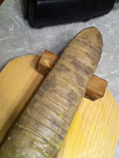

PostPosted: Wed 12 Jan, 2011 6:24 pm    Post subject:         Reply with quote
Ok, I made some changes. I took off the linen and washed it, sewing it on while it was still a bit damp and stretchy, added another X-brace of cording, and added a waxed linen section under the slider. I applied hide glue to the seam and the X-braced sections, which was a bad idea in hindsight because it quickly becomes sticky from the oil of hands or any moisture.
So, in an extremely modern move, I coated the entire scabbard with water-based wood sealer and wiped off the hide glue once the sealer softened it up. See, quite the mess I'm making here. But it's fun, so I'll keep on.
Johan's research on waxed linen is the way to go. I applied some wax from white tea candles and rubbed it in a section using an oak block. It'll work well for the rest of the scabbard and that is how I will finish it after the sealer dries. Ok, maybe the wax is a little thick. Time for the heat gun.
So, here are some pictures from when the sealer was still damp.

Nice to see your work, Tim!
It is looking very neat.
I think the binding can also go over the top of the linen, But that is just an option, and both ways are I'm sure "right"!
Very nice to see scabbards of this type. Thank you for posting.

PostPosted: Mon 17 Jan, 2011 8:02 pm    Post subject:         Reply with quote
Ok, tonight was the beeswax party experiment. I put 1 part linseed oil with 3 parts beeswax in a double boiler (glass jar in hot water on the stove) and stirred it on low heat until it was all liquid. I used a brush with animal hair bristles, so it wouldn't melt in the hot wax.
The wax brushed on easily and began to solidify so quickly that I could only make short single sweeps. That was plenty since it dried rather thick, but at least it went on uniformly. Then, after experimenting with a lighter to melt and rub off the excess, I decided to try a heat gun and work my way from the tip on up, occasionally tapping the scabbard on a resting block so that any melted excess would drip off. One of the photos shows the hot wax oozing from the surface.
The color changes spooked me at first when I started at the tip. The photo shows blotches that appeared with the use of the heat gun. Maybe that's where the oil or wax permeated to a deeper level, I'm not sure. The lighter, more natural color of linen that one might expect to see is most visible at the tip, where the overlapping layers prevented the wood from showing through the oiled linen. Geibig's illustrations show an overlapping flap at various points on the scabbard other than just the tip, and it is my guess that these overlaps appeared as rings or bands around the scabbard for those who drew depictions of Charlemagne and others with linen scabbard.
Overall I thought it went well, but the linseed oil is still going to need some time to dry out. It is all very waterproof now, so that's progress, and it smells like honey, so I guess that's period-accurate.
Does the Tinker Viking sword work well with this? I'm not sure. Maybe a Tinker Norman is in order.
In other scabbard news, my birch arrived today. So scabbard #2 is in the works.

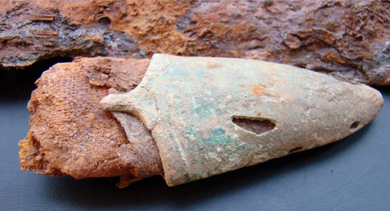

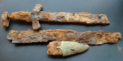

PostPosted: Sun 30 Jan, 2011 6:54 pm    Post subject: Latvia 10th C VIking Sword - Linen & Leather scabbard         Reply with quote
I dropped by eBay to see what "Viking" swords were showing up lately, and this "Xth C. Ancient Viking Sword" showed up from a seller in Latvia. Regardless of the accuracy of the claim, it's nice to see an old one with the leather on top of the cloth for the scabbard construction.
 Attachment: 131.78 KB
 Attachment: 109.32 KB

Arunas Bugvilionis
Location: Lithuania, Baltic tribes, Vilkatlakai
Joined: 24 Jan 2011
Posts: 41
PostPosted: Sun 30 Jan, 2011 11:52 pm    Post subject:         Reply with quote
Yes,in Latvia in some Lyvian burrials was founded bronze scabbard bindings with the scabard remains.So there is such combination: wood, linnen, leather; wood, linnen; in Lithuania is some findings: wood, linnen thread. Laboratory's analysis displayed that offten outer layer of the scabard was covered with wax,a bee wax of course Happy
So don't stop, You work well.

Artis Aboltins
PostPosted: Mon 31 Jan, 2011 2:06 am    Post subject:         Reply with quote
Nice picture, only sad thing that it is 99% sure attained by grave-robbing Sad since our government has very little experience with dealing with metal-detector using enthusiasts, some less-scrupulous of them are running wild and digging up everything they can find, and it is not possible to place a policeman on permanent station near every known burial site or hillfort. The fact that in most cases official science considers everyone of those enthusiasts to be a grave-robbers does not help either so we can only hope it will eventually grow into some form of mutually beneficial coexistence as it is elsewhere in the world (Straffordshire hoard find comes to mind as positive example of such coexistence).
