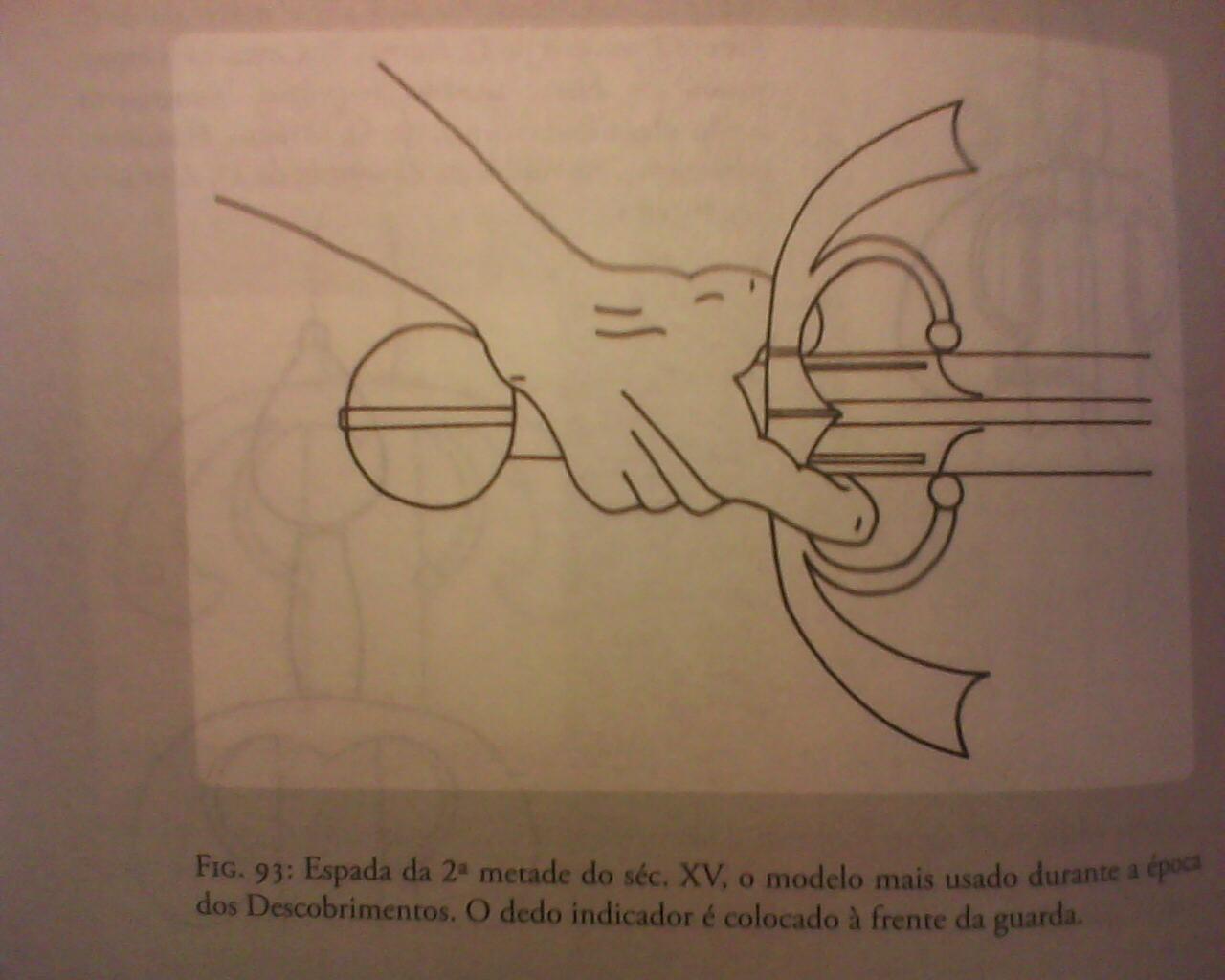

I believe one of the earliest examples of the finger rings feature in a sword guard would be the Espada Portuguesa, which is a rather unique type of sword that was used by the Portuguese sailors during the discoveries of the African Coast and the mapping of the route to India and Japan. This kind of sword design is first dated to the third quarter of the 15th century, and it's main purpose is to fight in close quarters, most of the time teamed up with a left hand parrying dagger.
Some examples of this type of sword:
In an attachment, i've added a picture of a sketch that represents an earlier sword, with a simpler flat disk pommel.
