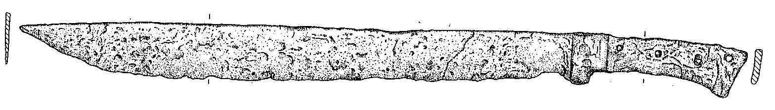

Magin, the first pommel you posted looks very much like a medieval sword pommel. I feel fairly certain it has not been dated correctly. Sometimes objects from later times "contaminate" find places of earlier periods.
(For example: there is what is almost certainly a medieval bauernwehr knife listed as a roman knife in the finds from Vindonissa)
The pommel is photographed from an unusual angle: the top. That makes it not so easy to recognize. You see the top hole an can almost see the bottom hole through it. It is a pommel of wheel shape (Oakeshott pommel type J). These were sometimes cast in bronze and then made hollow, just like this pommel.
Below some hollow bronze pommels displayed in Kopenhagen. They are not of type J, but I (or H). Otherwise you can see the likeness, with the holes for the tang and the hollow construction:
 Attachment: 61.12 KB
 Attachment: 88.18 KB
This may not be a very Roman knife even if it is found among roman equipment... [ Download ]
