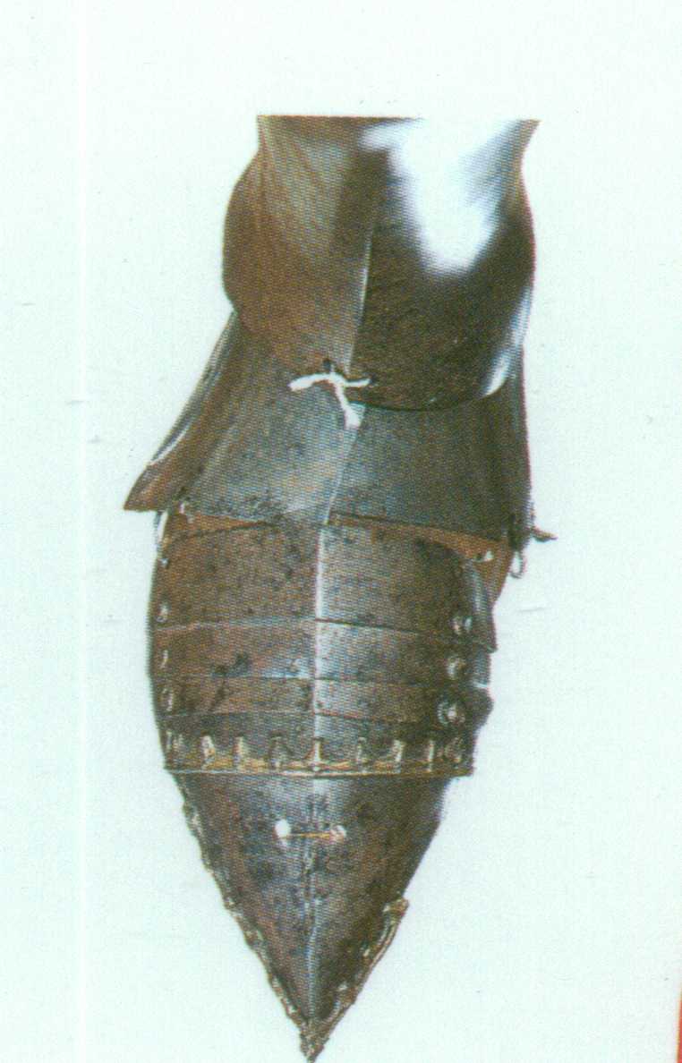

As for the sabatons, we're fortunate in having an extant pair that show us the answer. You can see one of Charles' sabatons below. Note the two holes on the toe cap; these are for points which attach to the shoes below. You can see a picture of me wearing a pair of almost identical design below, too. Here is an excerpt from a 15th-century document entitled "How A Man Shall Be Armed To Fight on Foot" (Hastings MS. f.122b) which tells us about this:
"He should wear a pair of thick shoes, provided with points sewn on the heel and in the middle of the sole to a space of three fingers. First you must set the sabatons and tie them to the shoe with small points that will not break."
So he's wearing heavy leather shoes with knotted cords stitched to the soles to give traction (which I think is a neat insight), and then the sabatons are tied to the shoes with points, just as in the Charles VI examples.

Hugh's Sabatons
Attachment: 63.4 KB
Charles VI sabaton [ Download ]

Michael S. Rivet wrote: | The sabaton bit makes perfect sense! Thanks so much for that. I'd somehow never caught the toe holes. So the points on the soles of the feet, do you pull those around and attach them to the sides of the sabatons? |
No, the cords attached to the soles of the shoes aren't points, they're actually like medieval cleats, for traction. I just realized I copied the wrong bit of text for that--the one I used is a version that's floating around the web, but it's actually incorrectly modernized and also incomplete. Here's a more accurate modernization I did:
"He should wear a pair of shoes of thick leather, and they must be fretted with thin whipcord with three knots and three such cords must be sewn on the heel of the shoe and in the middle of the shoe and there must be a space of three fingers between the frets on the heel and the frets on the middle of the shoe."
So, you see, you take six pieces of whipcord (not heavier material such as you'd use for points), and tie 3 knots in each (the knots are what provide the traction--they're the cleats, if you will). You sew three pieces of the knotted whipcord to the heel, and three to the middle of the shoe. That way, you get better traction on smooth ground.
Having said that, on the Charles VI sabatons, Mac put a strap under the instep of the foot and the strap ties to the inside side of the sabaton to hold it on. You don't need to do that with sabatons that have a heel plate because you can point the heel plate to the back of your shoe.
