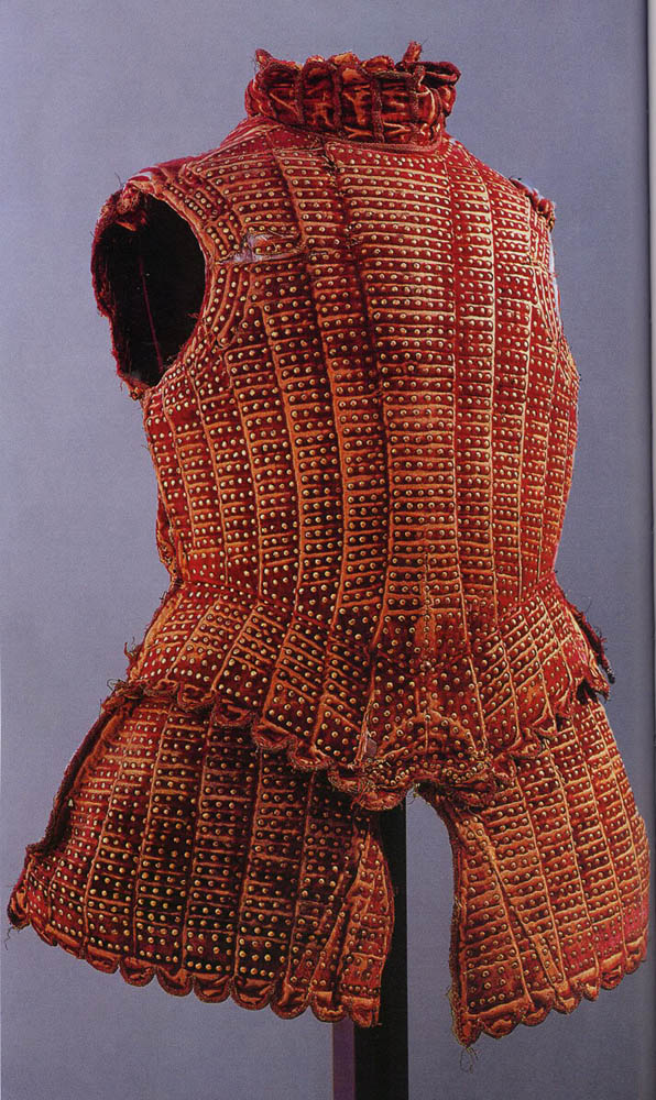

I'm currently working on a replica of this one, and I think (if the patterns and test peices I've got worked out are right) its about 6,800 rivet/nayles, in, I think, either 7,500, or 15000 holes, (assuming that each plate is peirced in rows top and bottom, and overlap with the rivets going through each plate...)
still trying to confirm wether they're peirced once or twice before starting on the metalwok, making sure its correct for 16th C brigs, though. I need more documentation on them....
I'm still working on the textile parts just now.... and have been for a while. mostly involving me staring at the peices, going "oh god, what am I thinking?!"
perhaps I'll just go back to 15th C reenactment. they're easy in contrast.
of course, I also want to make a replica of that Hirschstein Castle coat of plates you pictured, sam....
there's only one little problem with doing so... namely, I dont do 14th C reenactment, so would'nt have any use for it if I did.
(not that that's stopped me before, but I'm trying to have some common sense in what I make. armouring and RSI are bad combinations)
