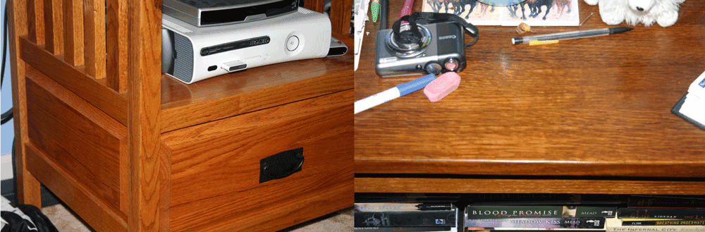

I you have an oak haft that has not yet been finished or oiled, you can expose it to ammonia fumes. (For furniture sized items I made a tent out of plastic sheet, but for a haft sized object you could just duct tape two garbage bags together and leave the hazardous fumes out in a garage for a day. 10% janitor strength ammonia poured into a bowl inside the bag or tent will work, but take longer than 30% Baume grade or the concentrated ammonia that blueprint drawing printing machines use.) It is the tannin in the wood that reacts. Brushing strong tea onto many other woods will enable them to respond to ammonia fumes as well. This essentially does replicate chemically what happens to old wood that has been in museums or up high inside old church ceilings for 100's of years with only indirect sunlight and slow absorption of chemicals from the atmosphere known to have altered the color of the wood.....not repeated oiling. It is also a very deep penetrating effect, typically at least 1/16" or 1.5 mm depth within a day for trials that I did. (Hard to beat for effectiveness on something that might get scratches and nicks...it will still look great!) A couple of articles I read described new and expensive bars or restaurants in Paris having it done to wood paneled walls and ceilings in order to give the impression of being a very old establishment. You don't see much color change immediately after the fuming. It is when you wipe the linseed oil onto the fumed wood that the color difference from the fuming abruptly emerges as a nice surprise!

PostPosted: Wed 24 Nov, 2010 10:28 am    Post subject: photos of oak finishes         Reply with quote
I took a couple of photos of two things that I made for my daughter. The TV stand has an artificial red tint look. It was finished with MinWax and Watco Danish oil products. The table top is a fumed piece. Both are oak, but the patina from fuming is much more brown and "genuine antique" in appearance. I fumed it a couple of days and had an almost black finish. I sanded it a lot, as in between 1/32" and 1/16" wood depth removal to lighten it back up to where the tone of color is more brown as opposed to Hershey's chocolate bar black-brown. The fumed finish does not have to use linseed oil. I just put Watco brand Danish oil on it after I discovered that just about any mineral oil based product, even most polyurethane products, would cause the fumed wood to darken when moistened. If you do this, put small test scraps in the fuming bag or tent. Oil a test scrap roughly once every 12 hours to see if it is dark enough. This is not a finish you just sand off.... It is deep and permanent.
 Attachment: 160.12 KB

Jared, thank you for such an extensive input! I will try this on an ash plank, to see how it comes out. First, the ammonia bag, followed by the linseed oil on one side, and beeswax on the other.
