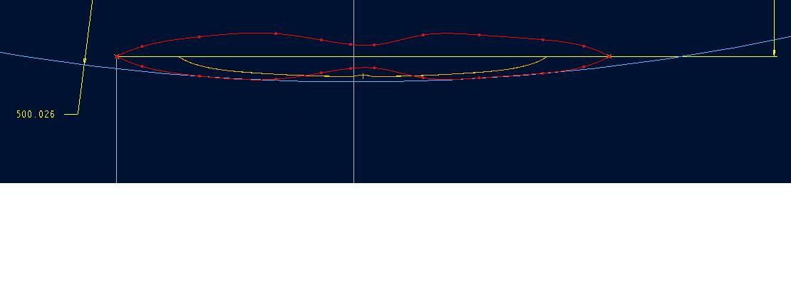

here a picture of a real section. The measures are 0.5 mm. under the guard. Why I got so close a section under the guard? To reduce the risk of any sharpening the sword may have had over time and that certainly had.
Analysis of the curves this section has, with reasonable deviations, two large arches and two smaller arches to the cutting line. Falls within my own definition of the third section. The measures at this point are: width 66.7 mm, maximum thickness is 4.85 mm.
I know you say I'm incurable for definitions and measures, Happy
but a guide should have it, so I enlisted the help of you all.
correction:
before: width 69.7 mm
after: width 66.7 mm
 Attachment: 5.88 KB

To make the idea better, if we exclude the fuller, the arc passing through the two main arcs has a radius of 250 mm. We note the deviation of the two smaller arches.
See the section in red, in blue circle passing through the arches of the section.
I repeat that this section shall be taken under the guard. How do I call this section? Question
 Attachment: 22.44 KB

I want to explain what I mean by micro-areas: parts of the sword than have small recess with respect to what should be a normal profile.
The question is, normal for who? If the area is original, and I repeat, if there aren't reasonable reason for believing altered, I must repeat that detail?
The visual appearance is not molecular.
Back up, see the photo, there are those deviations. My point is not whether this changes the qualities / handling, I know that does not change. Those recess are small but are visible to the eye. If you put the sword in front of you, note that there are. Is a detail, not important, I' agree, but there is.
My point is that maybe the ancient blacksmith wanted that form, I studying Oakeshott known that the details are important to him.
This is not to influence anyone, I just wanted to clarify the issue.
For macro-areas, I mean the overall profile of the sword, the section, the guard, the pommel.
On the sword there are many other recesses, but I do not speak of these, it is clear that it is re-sharpened, those is stupid replicate.
Below two photos: one without interpretation, the other, is a profile does not consider these recesses and followed a "normal" ideal line.
