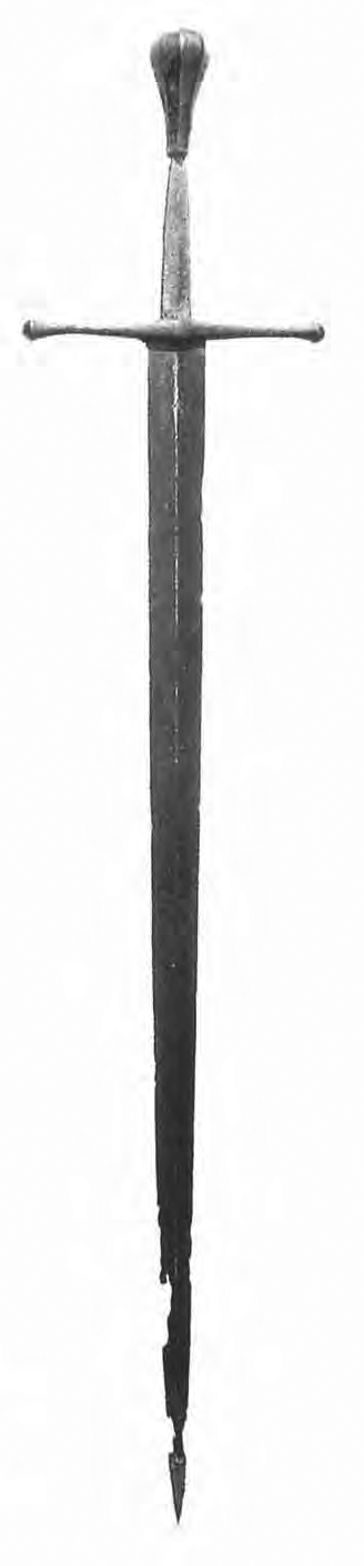

Here's the Castillon sword I mentioned. It's a bit longer than my concept--more longsword than single-hand sword. You can see that my pommel is fatter and shorter.
 Attachment: 132.88 KB

Hi Sean,
I think your pommel looks a bit too "knobby" because it's a bit shorter than the castillons pommel. It also looks like your pommel is about 2 or 3 mm wider than the blade? Can that be? The combination of pommel, guard and handle-length looks good on the castillon. You should not aim, for a too short handle on your reproduction. As your pommels form means to be hold with the left hand, perhaps it's just not suited for a single handed weapon? I think it seems more appropriate for an one and a half grip.

All good points. And, yes, the pommel is broader than the blade, which is the main reason it looks out of balance to me.
