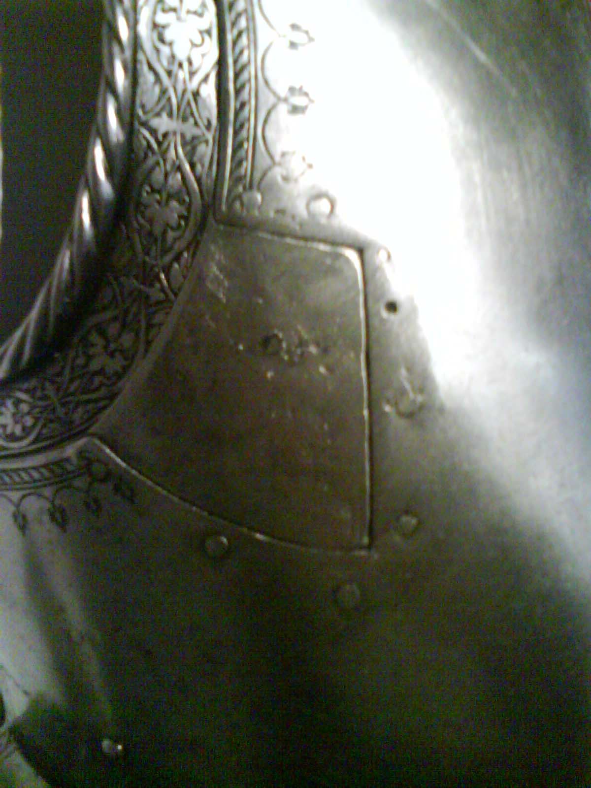

János Sibinger
Location: Hungary/France
Joined: 31 May 2009
Posts: 50
PostPosted: Tue 09 Nov, 2010 2:23 pm    Post subject:         Reply with quote
Greetings!
This question always kept me thinking, and one day in the Arsenal of Graz, I saw the answer! (Please note the picture!) Sorry for the poor quality of the photo, it was made in a dark room with my phone, but still, it could give you an idea! Happy
John
 Attachment: 147.49 KB
Repaired armour from Graz [ Download ]
Scott Hrouda
Location: Minnesota, USA
Joined: 17 Nov 2006
Likes: 15 pages
Reading list: 87 books
Posts: 643
PostPosted: Tue 09 Nov, 2010 2:43 pm    Post subject:         Reply with quote
János Sibinger wrote:
Greetings!
John
I've seen a very similar repair at a museum in Rothenburg ob der Tauber, Germany. I'll look through my old photographs to see if I have a snapshot.
