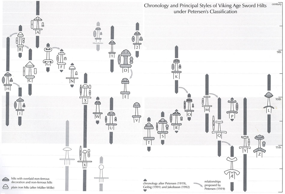

My understanding is that Slavic / Moravian swords of the period were exactly the same as the Frankish / Viking swords of the same period. From the limited number that I've seen, it seems that the Moravian swords tend to be on the sober side, so Petersen types H, N etc. (see attachment, which is a scan from Ian Peirce).
One difference seems to be that were Viking swords are typically peened through the upper guard, Moravian swords seem to be peened through the pommel.
 Attachment: 98.34 KB
