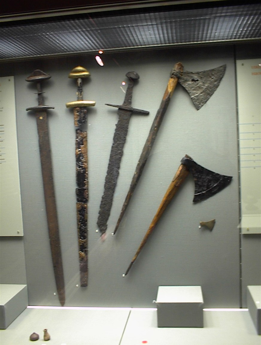

You know, a couple of weeks ago I was at the national museum in Dublin, and saw a couple of these axes with the complete hafts preserved. They were nothing like the common long hafted reproductions you always see. Now IIRC, the Bayeux tapestry does match the reproductions. But the ones I saw had very short hafts, about 40cm in length. Not only that, from the socket down they tapered into a pointed end. That means they could only have been held very close to the axehead, as the haft further down is very thin. I have no idea why the hafts were like that (throwing versions of Dane-axes?), but it makes it a completely different kind of weapon at least.

Did you happen to notice if the hafts were reverse tapered at the head? I'm assuming they would be but that process seems to be somewhat elusive in the info I can find. A short and shrpened haft like that could be used as a close combat (versus a spear or long hafted axe) to cut, thrust or chop as well as using the pointed end to stab with perhaps.
What do you mean by that, as in that they were fixed by sliding the axehead up the haft?
I've tracked down a photo of them, see below. The top one is actually longer then I remember, about 60cm. The haft on the lower one is about 45cm. Note that on the lower one, the haft just below the axhead is wider then the socket, with some wood supporting the axehead in front of the socket on the lower side of the axehead.

Jeroen wrote : What do you mean by that, as in that they were fixed by sliding the axehead up the haft?
Yes, the axhead slid slid up the haft, then forced tight into place.
I see the smaller axehead sitting on a "shelf" in your picture. Is the head then wedged against the haft using shaped pieces of steel or wood driven between head and haft to lock it in place? Like a shim?
