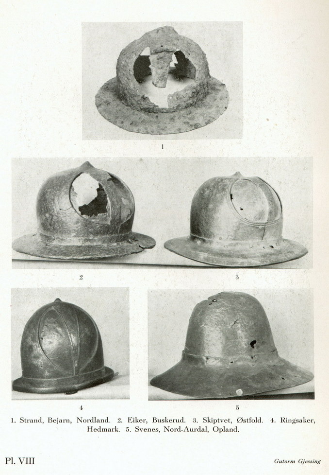

Though it's probably not that usefull to you, here's a picture of the Norwegian finds, dating from the 13th c. onward.
As you can see, most of them are of the distinctive, scandinavian "onion head" style. This kind of helmet is depicted all the way from the 12th to 16th c, though there are also illustration of the "standard" european style.

the helmets are all metal; some of the thinner side pannels have simply corroded away. They have been laying around for 6-800 years, after all.
These helmets are of advanced craftsmanship, and typically vary a lot in thickness. For instance, the edge of the brim in very thick, narrowing to 1,5mm towards the base. The same goes for the "ribbons" over the top. The side panels are, as can be seen form the corrosion, very thin.
