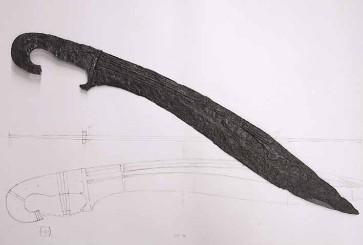

The first is a falcata in rather good condition. It feels if it has some sound steel below the rust as the weight was there. Sturdy spine and a keen edge geometry.
First a complete wiew:
Attachment: 40.58 KB

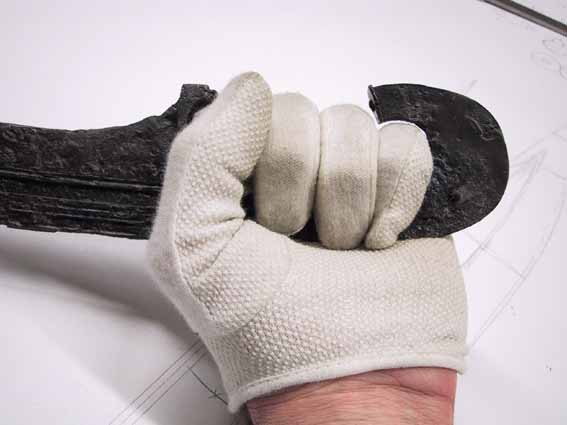

And so a pic of my left hand grasping the hilt to show how well it is made to fit the hand:

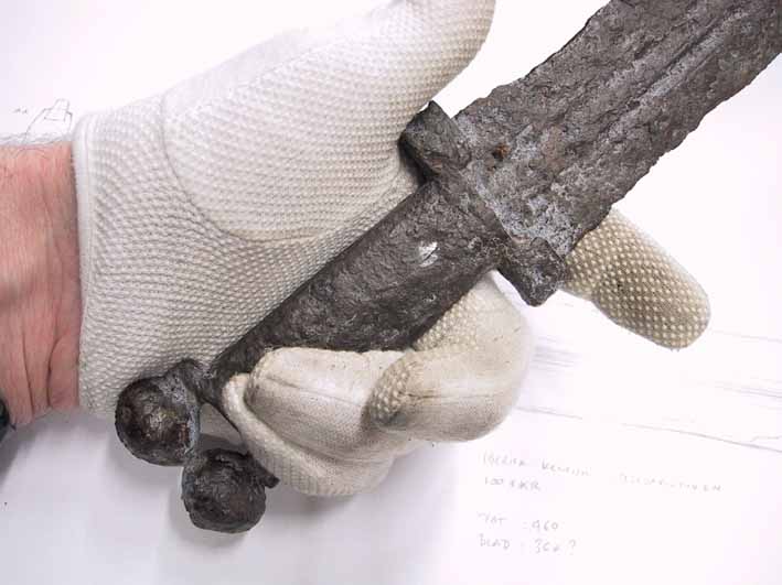

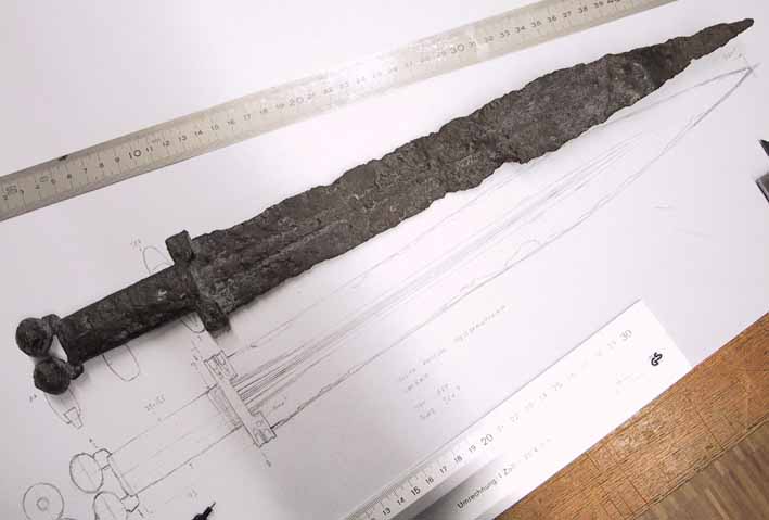

A well preserved antennae sword was equally impressive. The hilt was made in a all-steel construction with a hollw grip that still showed the seam on one side. Not welded shut, just made to fit very tightly. The cross, or guard, was wrapped around the base of the blade and fastened with two rivets. Some file work was added sparingly to great effect.
The spheres at the end of the antennae arms were hollow, riveted together by the protruding arms.
I think there exist some swords of this type that are slightly longer, but not much. This was not much bigger than a very large dagger, but absolutely had the feel of a sword.
Attachment: 51.63 KB

I have always liked the looks of a Falcata.
Seems to me that it would be a nasty weapon too.
What is the bladegeometry like?
Does the edge start from the spine so to speak, or it is more oval in shape?
(I hope you understand what i am asking for, i cant seem to put what i mean in words.)

Again, to get an idea of its size my left hand is holding the sword. As you see the girp is not very long. If you grasp it tightly your hand will be pressed between the guard and the antennae. It is no uncomfortable but makes for a very secure grip.
It does not show very clearly in the photos, but the blade had a nice and crisp cross section with a set of fullers and risers that were skillfully filed and/or ground.
Attachment: 62.31 KB
Geoff Wood
Posted: Thu 11 Sep, 2003 3:52 pm Post subject: |
Mr Johnsson
In the falcatahelbild jpg, on the drawing you show some additions on the hilt. Are these just measurement lines or some speculation as to additional structure that has been lost?

Fredrik Hörnell wrote: | Nice.
(I hope you understand what i am asking for, i cant seem to put what i mean in words.) |
The very sharpness of the edge was coated in rust and a bit eaten away, so we´ll have to guess a bit how it was originally. It is not a shot in the dark however. The blade had a cross section that was like a very thin triangle, some 6.5 milimeters at the thickest. The edge would have been sharpened with a slight convexity in the last three or four milimeters or so. The section of the blade was fine and well defined. The sharpness would have been formed from a thickness of a milimeter or slightly less.
The thick part of the blade was made lighter with a set of grooves that were flat in the bottom, not rounded. I got the impression they were cut with a sharp chisel. Very crisp. There was a broad sunken area that might have held a panel, perhaps of silver (perhaps with engraved designs)?
On other flacatas the cross section is more dynamic I have seen an example where the edge was more like a pointed drop and the main face of the blade had a concave dip, or wide fuller, from the thick spine to the rising thickness of the edge. This is alike some well made kukri knives you can see today.

Geoff Wood wrote: | Mr Johnsson
In the falcatahelbild jpg, on the drawing you show some additions on the hilt. Are these just measurement lines or some speculation as to additional structure that has been lost? |
The transverse lines across the tang is a projection of the guard, seen from the nd of the grip. It is made from two filed plates of iron riveted to each side of the blade. (These rivets are invisible, I believe they are countersunk and hidden beneath the rust)
At the end of the grip there is a small hexagonal plate riveted in right angles to the tang. This gives a clear indication to what shape the grip scales were fashioned, at least toward the end of the grip.
There is a small ring integral to the blade at the spur of the guard. This indicates there was once a small chain between the end of the grip and the spur of the guard. I sketched this chain in, just as a remainder. My guess is that this could have been made from a contrasting material, perhaps bronze or silver. Or it may just have been iron and rusted away.

Posted: Thu 11 Sep, 2003 4:10 pm Post subject: |
Peter Johnsson wrote: | Fredrik Hörnell wrote: | Nice.
Correction:
Sorry, the cross section was not that flat as I first said. From the grooved part it curved gently down to the edge, giving the last half of the blade toward the edge a convex shape. It still was fairly thin, though. The upper half of the section, towards the spine had a taper to it so the start of the convex part was thinner than the spine.

Posted: Thu 11 Sep, 2003 8:08 pm Post subject: Distal taper? |
How about distal taper on the falcata? A lot or a little? Continuous or at different rates along the blade?

Darwin Todd wrote: | How about distal taper on the falcata? A lot or a little? Continuous or at different rates along the blade? |
Taper in the tang and varied taper in the blade: mild untill the clip point, then more marked towards the point.
