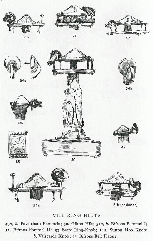

Here you go. From "'The Sword in Anglo-Saxon England''.

Hey Peter,
Here is a thread that may be of interest...
http://www.swordforum.com/forums/showthread.p...t=ringhilt
I don't think the Sutton Hoo sword was a ringhilt. Seems like there was a ring found attached to one of the drinking horn in the Sutton Hoo Find.
I have also attached some pics of one of the Kent Ringhilt Finds... It is the Dover find in the British Museum. The pictures are by Jeroen Zuiderwijk.

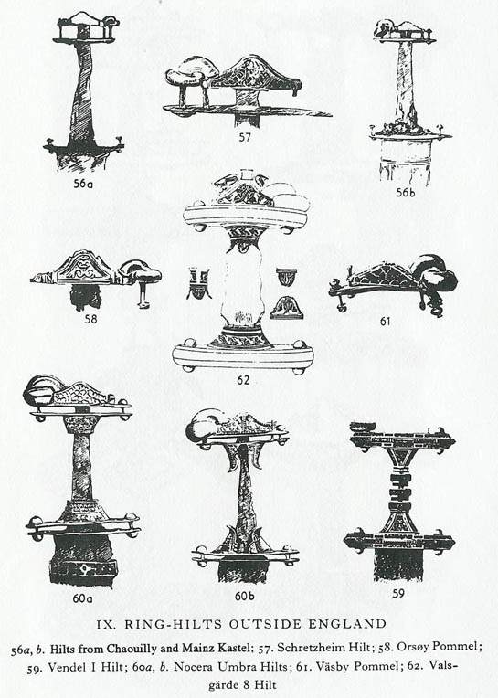

For this sword, I think the following is more or less mandatory:
- Cocked hat pommel, with or without ring
- Sandwiched metal-organic-metal upper and lower guards
- Organic grip, either bare, with clips (like 60b in the attached pic) or cylindrical fittings (like 60a, both are from Nocera Umbra).
Since this would have been an extremely high status sword, I think that garnet cloisonné work on the pommel would be likely, but of course it depends on taste and affordability. If you do decide to go this route, then I would use real garnets instead of glass, although green coloured glass was occasionally used. This gives a really striking effect, but in my opinion should not be used to imitate garnets. A completely period way of reducing cost is to use gold-plated silver or bronze instead of solid gold.
I would also not use bog oak, as I don't think it's likely to have been used in period. I do like the white and gold combination, so bone, horn or ivory would be nice. But black horn is also possible, as are native woods.
