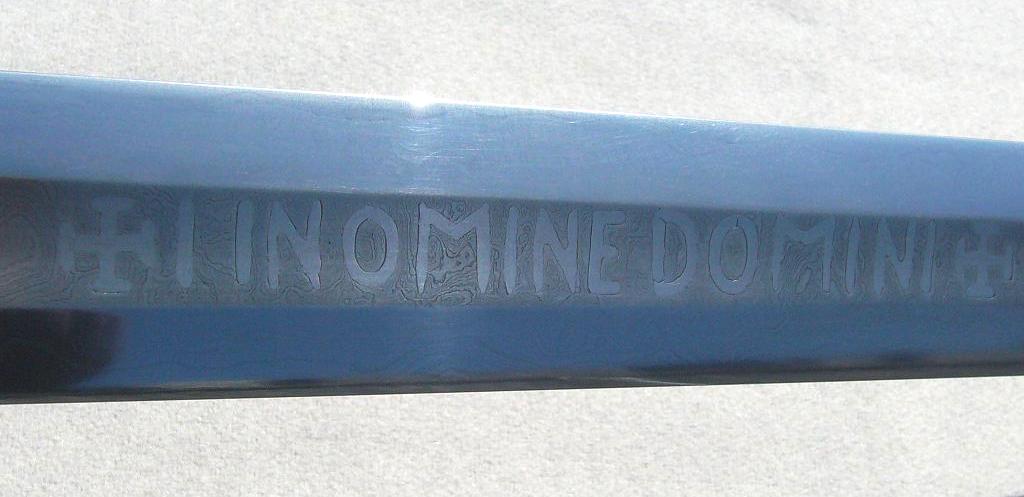

Hi all
There are images of reproduction " Gicelin " Sword made by Robert Moc after Records of the Medieval Sword 2 years ago for customer from France.
 Attachment: 63.37 KB
 Attachment: 70.89 KB
 Attachment: 101.27 KB
Jeremy V. Krause
Location: Buffalo, NY.
Joined: 20 Oct 2003
Posts: 1,717
PostPosted: Thu 15 Jul, 2010 12:11 pm    Post subject:         Reply with quote
Well, look at that!
That's cool! The inlay looks great! I don't know why the fuller seems to be pattern welded but the inlay is still fabulous!
Thanks so much for sharing!
Also why is it double fuller on the +GECILINMEFECIT+ side? Interesting.

I don't see a double fuller, maybe shadow tricked you?
Btw, I would love to see more pictures of this replica if possible, please? Wink
