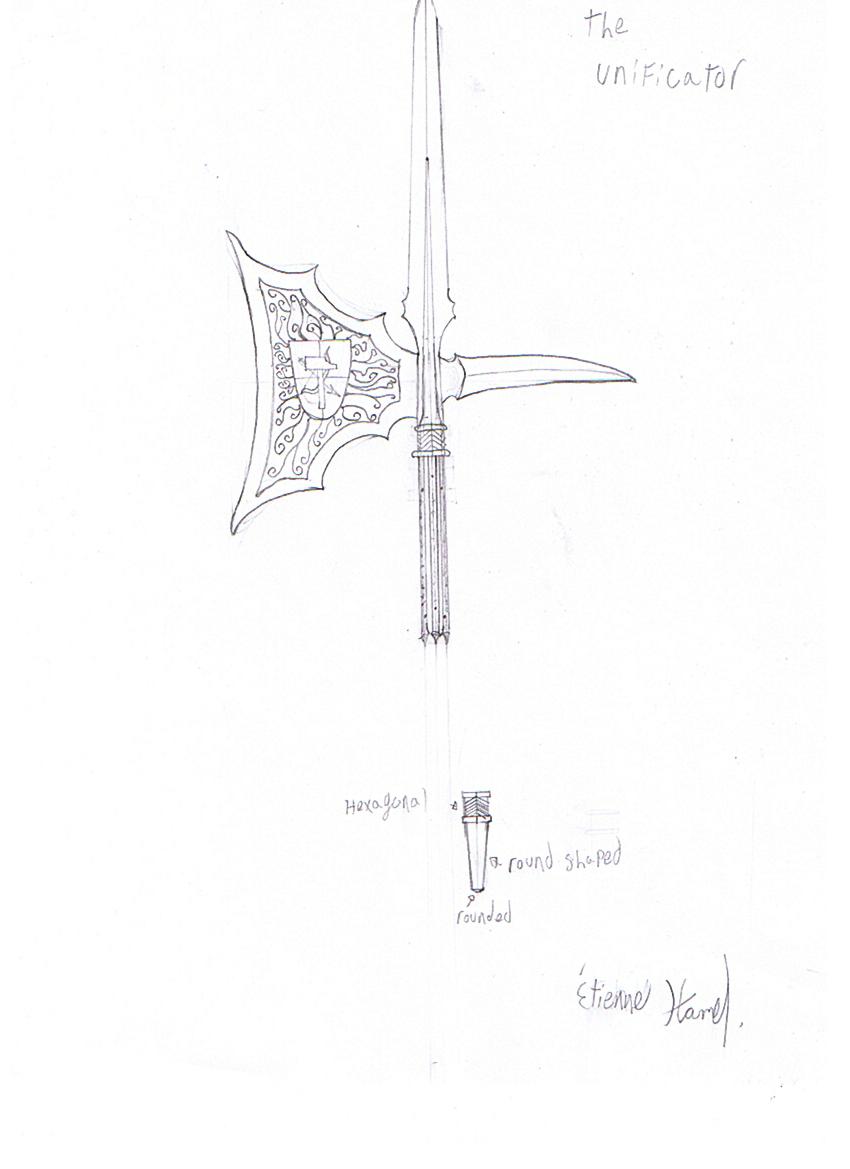

i made a concept drawing of the head and buttcap just to have an approximation of what i want, of course it is 2D drawing so i don't have th other side view.
i'm finishing the buttcap and i'll post it.
ok here is the draft for the unificator (the halberd's name)
i'don't know if you can see it well but anyway tell me what you think.
by the way i don't know why but on the scan of the image it looks like one of the languets doesn't show very well...
