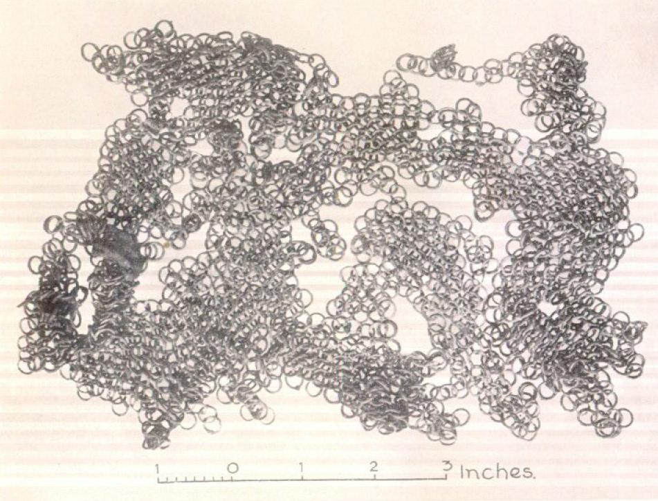

There are a few excavation reports floating about.
This is from a note by Burgess about the Carlingwark Loch mail.
Alternating rows of riveted and punched links.
Riveted links have thickness varying from 0.032 - 0.042 inches
Outside diameter varies from 0.286 to 0.323 inches.
Round rivets, round section. No visible "watershed" formation.
Punched links have wire thickness varying from 0.039 to 0.056
External diameter varies from 0.267 to 0.274
Links are flattened with "somewhat square" section.
Corrosion would have distored the figures quite a bit. No way to tell what the original thickness was but outside diameter would be pretty close.
 Attachment: 127.31 KB
