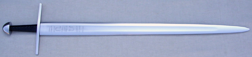

Hello everyone,
My name is JT Pälikkö and I have worked as a full-time bladesmith for almost twenty years now. I have mostly worked with all kinds of knives and puukkos, but over the years I have found myself making increasingly more swords and other historical weapons for my customers. This is the first time I participate in a discussion here in the myArmoury forum.
A few days ago I showed some pictures of a work I just recently finished to an old customer of mine. He in turn suggested that I would share some pictures and maybe some information of the process of the project here. So here goes… -hopefully this does not turn out to be too long or boring…
The project I just finished is a late “viking era” Xa-type sword I was commissioned to make couple years back. The sword itself is a quite straight forward piece, with simple hilt furniture and a hefty blade.
However, to turn the sword into something special, the customer ordered it with a pattern welded inscriptions. I told the customer that I had never actually tried forging inlays, but I was willing to try my hand with them.
Last February I finally started the manufacture of the sword. I thought it best to use easily weldable carbon steels for the whole project. The blade material used was 0,75%C carbon steel and the letters were made of twisted rods of 15N20 and 1%C carbon steel.
The letters were bent from 2 – 2,5 mm round rods, I tried to keep the amount of parts per letter in minimum, so for example letter M was bent from one long rod. In the actual welding process a gas forge was used. No grooves were cut for the letters, the cold letters were forged into the hot blade blank instead. To stop the letters “hopping off” while they were being seated I made a small hammer with a longish metal tube handle (just the kind Richard Furrer describes earlier on). This hammer was wielded by an apprentice (strangely similar in appearance to my wife). After a few practice welds, the process was fairly straightforward: I held the blade blank and after the initial heating I brushed of the scale, placed the letter on it with tongs, the “apprentice” would place the hammer on the letter and I would strike it with a bigger hammer. After a stroke or two I would add flux, heat the blade with the letter into welding heat and lightly forge weld the letter in place. With enough heat left in the blade next letter would be set on it and the cycle would continue.
With the aid of extra pair of hands, the whole process was surprisingly fast, it took less than an hour to weld the inscriptions and decorations on the blade.
After the forge weldings, the fullers were forged in using two-sided fullering tool. I removed all scale and leftover flux from around the letters before forging the fullers to ensure that there would be as few surprises waiting as possible. Finally the bevels were forged in shape and the blade was ready for rough grinding and heat treatment. The finished blade was etched using ferricloride, which brings out the nickel in the 15N20-steel in the inscriptions nicely.
As for the actual inscription, well, it’s maybe a bit bombastic, but it is nevertheless quite true and just what the customer and I agreed upon when the order was made. The rather simple decoration on the reverse side of the blade is adopted from one “ULFBERTH” blade.
Here’s two annoyingly small pictures of the sword.
 Attachment: 74.52 KB
 Attachment: 32.87 KB

A little more to the previous post:
Here is a picture of the inscriptions, showing both sides of the blade.
There are few faults in the inscriptions, most notable being the one in the right “armpit” of the letter M. In my mind, the reason for it is the rather massive size of the letter, which in turn forces the energy from the hammer blow to spread wider and weaker. Also, the metal under the letter might have been slightly too cold, so the metal has not molded itself as well around the letter as it might have done had it been hotter. The tight curve in the letter J seems to have the effect of pushing the metal underneath it “aside” while the letter is being seated, I noticed the same effect in one of the omegas in the reverse side. The same omega sports a torn seam in the tip that has most probably occurred while hammering the letter into the blade.
Considering the overall difficulty of this sword project, I am personally very satisfied with the end results: all forge weldings held until the end, no letters fell off during forging or heat treatment, no letters or parts of them were erased during grinding and when etched, the inscriptions showed up loud and clear…
 Attachment: 90.58 KB

What, - just plain “X”? Oh, blast! Now I have to chuck that thing into the garbage bin and start all over again!

You are quite right, Maurizio, the sword is more an ”X” than ”Xa”. And yes, it is rude to snap at people for being right. The truth is that this sword project has caused so much anxiety to me in various ways so that even my usually nigh limitless reserve of patience is starting to run out.
As for the X/Xa dilemma, I went through quite a few Finnish founds looking for the most suitable cross/pommel combination for the blade, I probably just got them mixed up in the end…
Besides, my original postings were meant to be a continuation to another thread, I did not intend to start a new thread, my posts were just moved here under this title/subject.
Mike, I have to say I’m with you there, the typology is a very necessary tool to keep all the information in some sort of order, but it just provides the essential backbone for the study. Personally, more I get to study the originals, more often I manage to stumble over swords that do not fit really well in any category. Then again, my “forte” is not really the typology side of things, basically I am just a dumb craftsman working amongst charcoal dust and sparks.
Anyway, let’s all agree that the sword is indeed an “X” and be happy about it.
Btw. from tomorrow onwards, that sword will be on the free market, ie. the claim of the original customer expires today…
