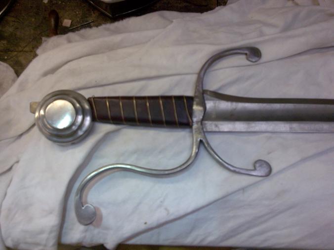

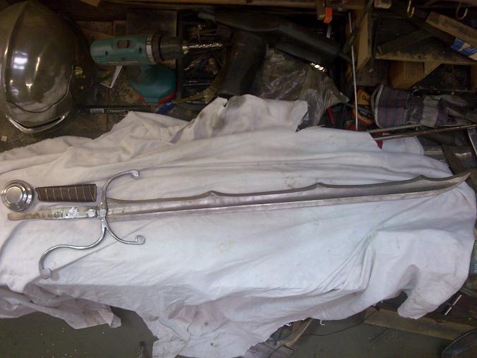

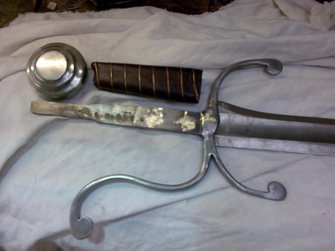

Here is a project Iv been working on. I'm constructing this Storta to be suitable for re-enactment, note the cheek plates on the crossguard fixed to the tang and the tang going through the pommel to be peened.
Iv made the pommel using only the forge and grinding as i prefer to see a pommel on my work that has that 'non machine turned perfection to it' as historically they would not have been exactly round. I'm going to interference fit the claws/spikes after peening to the pommel.
At the moment its on stanby by to being Hardened and Tempered along with the Fish Tail I'm making as well.

I don't think I've seen an offset wheel pommel before. That is interesting. Do you have any pictures of historical pieces with that detail?

The offset effect on pommels and grip ends of falchions, stortas, coletllaccios and messers is not the result of a normal round pommel mounted of center.
It is a "curling" form a bit like the head of a violin. You may think of it as a birds head: sometimes it is shaped with a beak, and sometimes it has this rounded end. The neck of the form is as important as the offset of the round end or beak. If you look at the photo of the Met one, I think you can see it has an all steel grip (hollow) with integral pommel. This is a bit unusual, but it does not stray far from the normal shape of these grips.
The Met Storta is published in "Swords and Hilt Weapons" a popular book presenting bladed weapons over time and in various cultures. It has a list of photographs in the end where origin and some times inventory number is presented.
The lower forward arm of the guard is a finger guard. Many sabers, Falchions or Stortas and Hangers of Italian manufacture have this feature.
Stortas can have round pommels, but these are then mounted centered, just like any sword pommel.
the round shape of the wheel pommel and the beak on the birds head pommel all serve the function of a hand stop. It helps the grip from slipping out of the hand in a swing.
Storta is the Italian name for Falchion. Stortas are not separated from other weapons in this group, meaning they are not different from Falchions other than they sometimes have features that are more popular in Italy than in other places. Functionally they are the same as any Falchion. Just as with Falchions, they sometimes dress up in many features of the Messer, making distinction between the two not always clear. The italian name for Messer is Coltellaccio (=big ugly knife). From the word Coltellaccio comes the well known name Cutlass.
EDIT: finally a word on that less than perfect look on original weapons and armour. It is one of the hardest things to get right. Modern sloppy or careless work does not come close. There are no short cuts to get there. We have to have a very good understanding of form and long experience of the craft and materials to be able to work with the confidence, speed and light hearted attitude of the masters of old. Only with this level of skill can we arrive at that effortless, asymmetrical, organic but still "perfect" shape. It is a life time of learning and striving. Before we get there it is important to aspire for as high level of perfection as we can. We will never really get there and that is a good thing Wink Cool
Sorry if I got into preaching mode, but talk about less than perfect shape always set my alarms ringing. It is so dangerously close to a mindset that is comfortable with a sloppy attitude towards work. I am sure you did not mean this. I just wanted to take the opportunity to focus on this important aspect of the craft.
