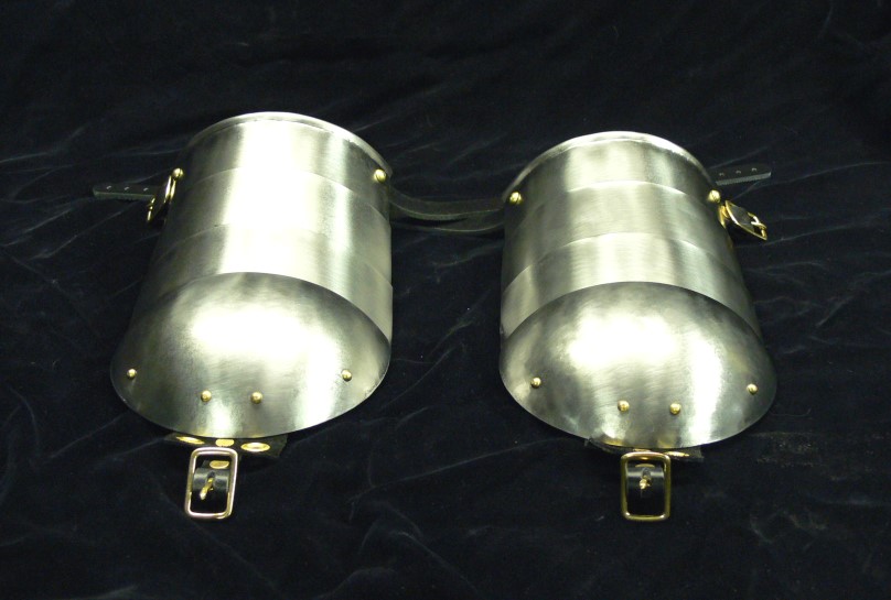

Hello all, I am wondering about shoulder plate armour in the 1320-1350 period.
I kno about the solid disk pointed to an undergarmet,
but I was really wondering about this piece for merctailior. The styling seems to be right, but would the multi-lame construction be too advanced for the period?
Also, on the actual pointing itself, would one have points on the gambeson/aketon/arming coat, or just point the armour directly to the maille? It sounds horribly complicated to get the points in between rings in the maille, or is there a way to do this right?
all help is appreciated, thanks.
 Attachment: 95.88 KB
the shoulder armour in question...... [ Download ]

Maybe not quite 1320s by 1330s though I think something like it perhaps. First thing we need to do is look at artwork from that time. Effigies (gothic eye is good but there are some good ones coming up with more effigies in them), artwork (like the Romance of Alexander 1344) you need to see and get familiar with the differences between shoulders protection in the 1st half of the 14th, 2nd and into the 15th.
I'd say these really are not 14th, especially not the period of the 14th you are looking for. Take a look at the mourners on the Hastings effigy for example. tons and tons of spaulders but they are unlike those ones in a few ways. One the top plate is much shorter. Another is the lower lames are thinner. Last is that they do not extend down the upper arm as far. When you look at spaulders of the 14th century they tend to be fairly short compared to late ones coupled with long rerebraces.
If you contact Merc Tailior I suspect he could easily make what you are looking for. I have a pattern kicking around here of one as well.
The picture Bryan posted to me is 1280s to maybe 1310s but during the 1310s is when the number of bits of plate begins to proliferate rather quickly. By 1320 it has become fairly common to have plate limb armour of some nature.

I think if you look at Romance of Alexander it is clear that simple types of espaliers are relatively common by the end of your period (1350), but maybe in 1320 not so much.
I have those and disagree with Randall a bit, stylistically they are not that long. On my arms they don't reach a rerebrace for use in a 15th c kit. I point them over mail at the shoulders for my mixed mail and plate and COP 14th c outfit.
They are fairly simple and are on leathers only. The dishing on the ones I have are nice and the bottom lame has a rolled edge. simple effective shoulder armour.
I am sure Allan could make a three lame pair for you if you wanted instead of four or you could just cut and re-do the leathers using three lames instead of four.

I don't know still. The differences between it are more than simple length. On first half of the fourteenth century spaulders the lames are short, the top cap is short and generally the spaulders are short because of this. This works because the rerebraces were long, likely nearly the entire length of the upper arm. This is very different from fifteenth century, even some second half of the fourteenth century spaulders and rerebraces, where the former get longer and the latter get smaller.
I have no doubt that merc tailor could easily do it but off the rack like this they just do not look like any evidence we have for first half of the fourteenth spaulders. That said the shoulder cops I &II are good for this date off the rack.
