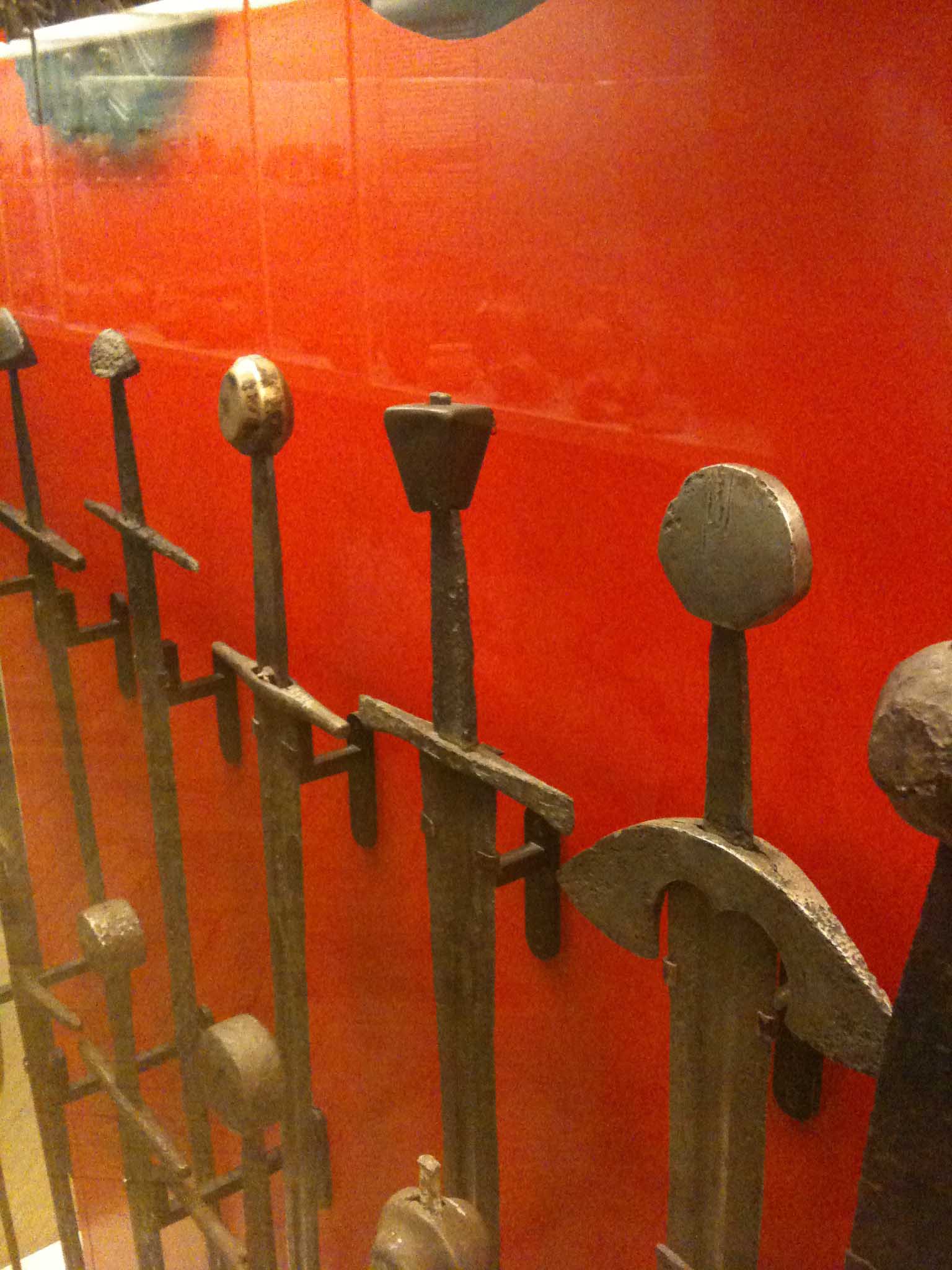

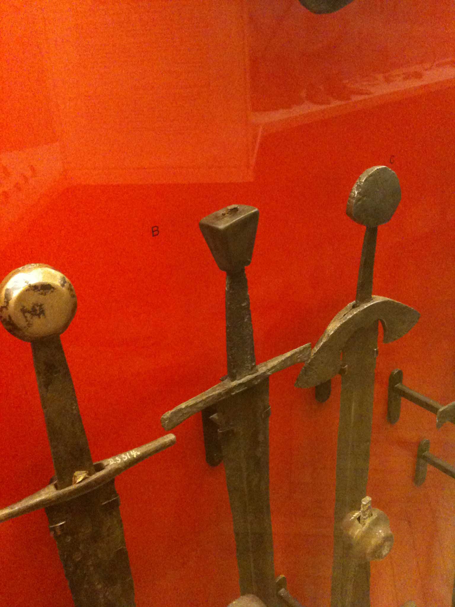

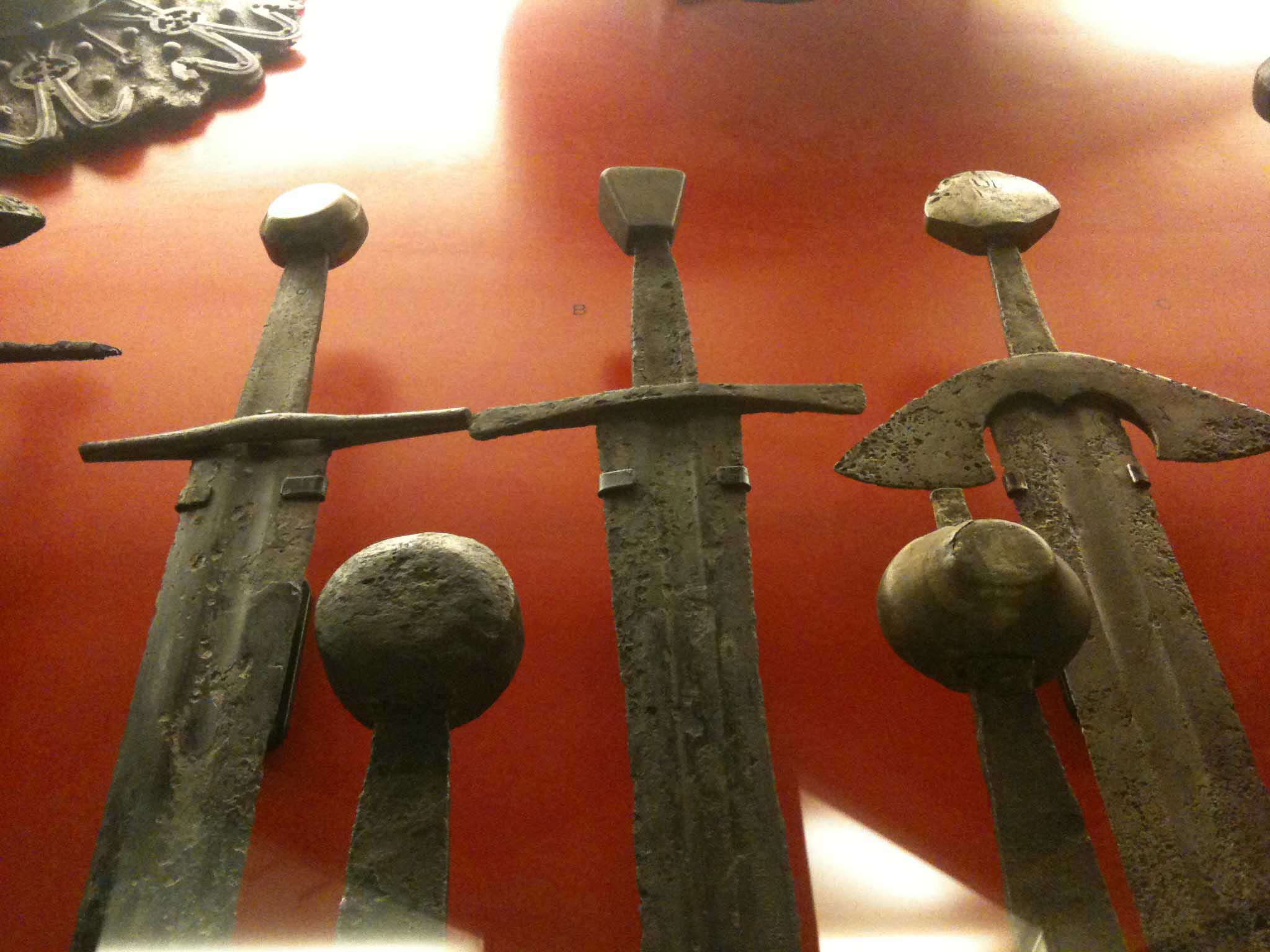

Since my office is only 5 min´s away from the National Museum in Copenhagen I jumped at the chance to go have a look at the swords again. The sword you are looking for is on display. I have attached a couple of pictures taken with my iphone (sorry I have no better camera at the moment). I hope they can help a little. It´s a very nice looking sword :-)
Not easy to get photos that give you more info though ... I will PM you the email to a guy who works at the museum and who can help you find the right person to answer questions about it (don´t know if they have any more info than you already have).
If you want me to try and look at a particular detail of the sword let me know (admission is free to the museum).
Best wishes,
Søren

Thank you very much for taking the time to grab and post these great pictures. They may come from an Iphone, but they are still the best close pics of this sword I've seen...very informative too. I know now how the guard looks in section, and have a better idea of how the pommel is shaped (I would never have guessed it was so thick). If you need me to return the favour in any museum in London, don't hesitate to ask!
Given the way the display is set, it seems impossible to get a full size shot...but if you were to go there again, I'd love a shot of the last third of the blade, especially from the end of the fueller to the tip, where the blade profile turns to flat diamond.
This is a feature I am not planning (or able!) to replicate but I've also heard that the fueller is flat. Is that a noticeable feature when looking at the sword in person? (I can't say for sure from the pictures).
I will write to the contact you provided, to ask for a high res pict of the entire sword (the museum supervisor of Westminster Abbey offered to provide this for the Henry V sword last I went there so this might be possible without too much hassle for a small fee).
