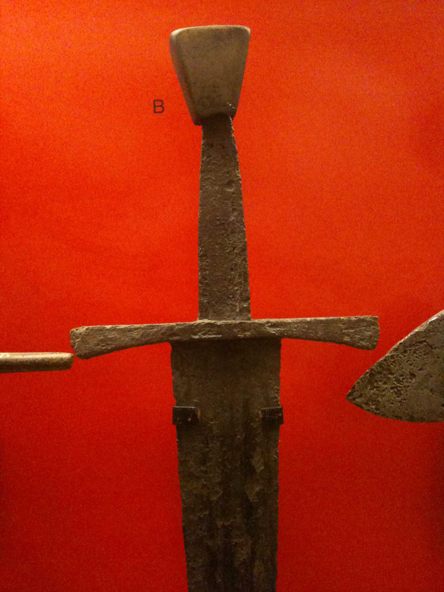

Since my office is only 5 min´s away from the National Museum in Copenhagen I jumped at the chance to go have a look at the swords again. The sword you are looking for is on display. I have attached a couple of pictures taken with my iphone (sorry I have no better camera at the moment). I hope they can help a little. It´s a very nice looking sword :-)
Not easy to get photos that give you more info though ... I will PM you the email to a guy who works at the museum and who can help you find the right person to answer questions about it (don´t know if they have any more info than you already have).
If you want me to try and look at a particular detail of the sword let me know (admission is free to the museum).

Thank you very much for taking the time to grab and post these great pictures. They may come from an Iphone, but they are still the best close pics of this sword I've seen...very informative too. I know now how the guard looks in section, and have a better idea of how the pommel is shaped (I would never have guessed it was so thick). If you need me to return the favour in any museum in London, don't hesitate to ask!
Given the way the display is set, it seems impossible to get a full size shot...but if you were to go there again, I'd love a shot of the last third of the blade, especially from the end of the fueller to the tip, where the blade profile turns to flat diamond.
This is a feature I am not planning (or able!) to replicate but I've also heard that the fueller is flat. Is that a noticeable feature when looking at the sword in person? (I can't say for sure from the pictures).

Just wanted to share the results of my investigation on this sword at the Nationalmuseet in Copenhagen. The curator has provided me with the below:
The sword (inv. nr. 16163) was found in 1857 in a moor called Ordrup Moor close to Copenhagen. The double-edged sword has a length of 93.3 cm, the handle (including the pommel) is 15.7 cm long, and the blade is 5.5 cm broad at the top. The cross guard is 15.6 cm long and flat towards each end. The pommel, which is hollow, is made of a bronze-like metal.
The inscription + N n D I G + on the blade is inlaid in brass, but it has not been possible to interpret the words .
Interestingly enough, I took for granted that the sword, being a typical type XVI, would be dated to the first half of the 14th century. But I've been told by the museum that they considered the sword to be almost 100 years older.
