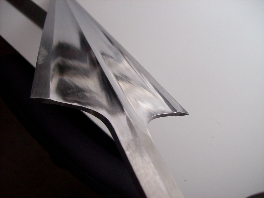

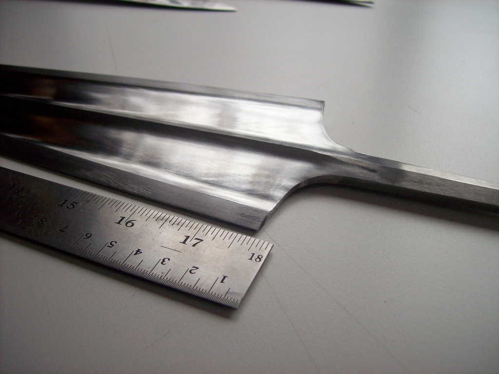

Here are some early pics of the blade where you can see the strong central rib that extends into the tang at full thickness giving it maximum strenght even if it is narrow.
The fullers are ground as flats surfaces rather than just being an arc defined by the diameter of a grinding wheel and the blade is forged as opposed to ground from stock.
The mid rib is a air under 3/8" thick by the way.

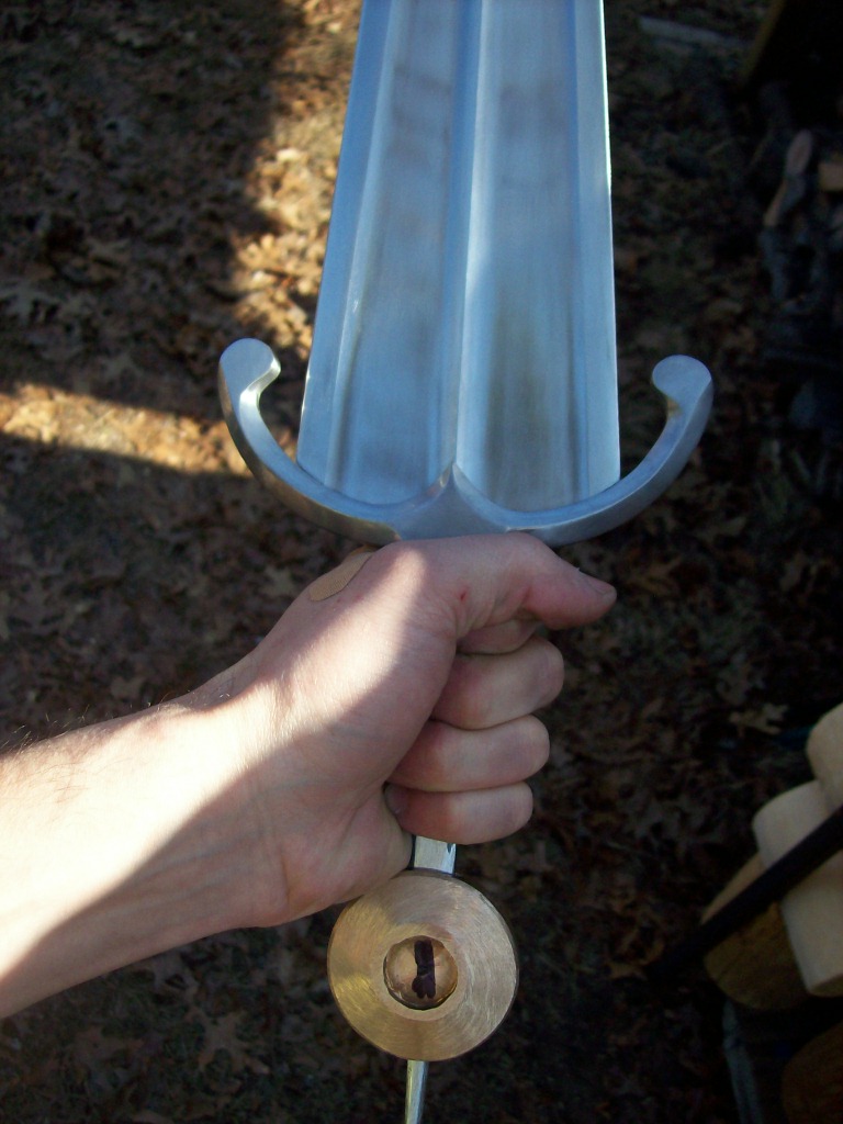

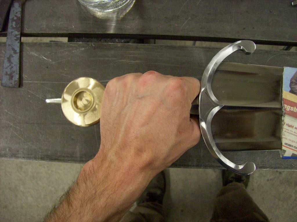

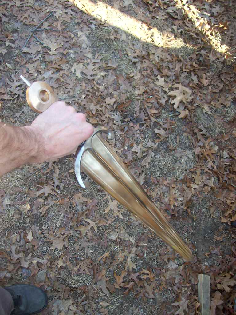

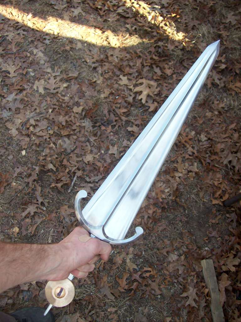

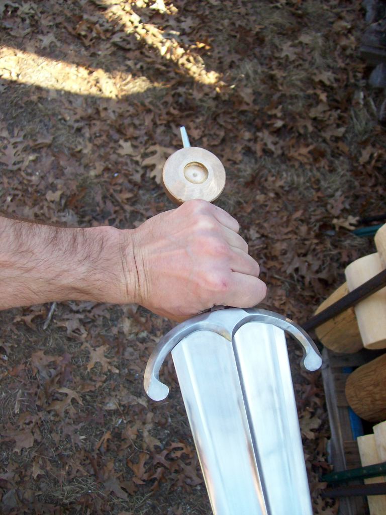

Here are more recent pics much closer to being finished.

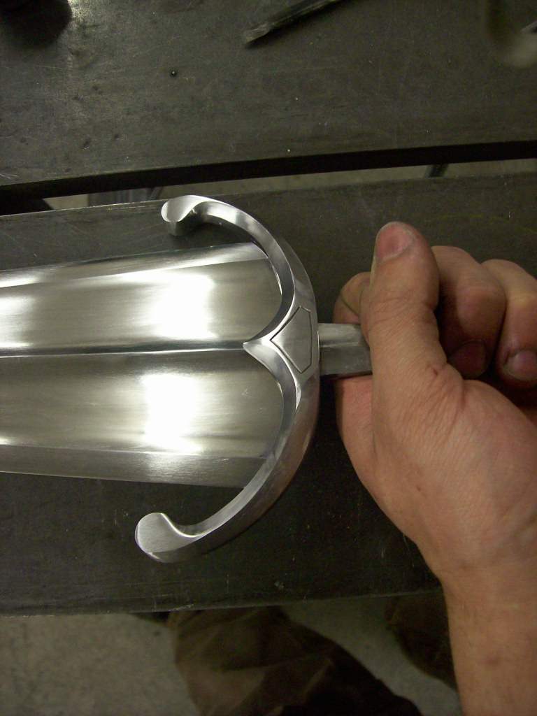

The most recent pics: Michael has slimmed down the guard and sharpened the bevels and ridges as he considered and I agreed that the guard was just slightly too chunky.
He also added some engraved lines.

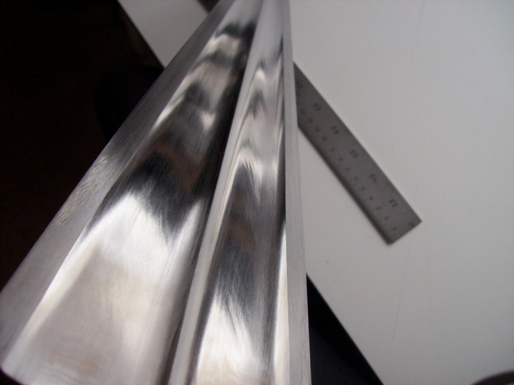

Here are a few more pics of just the finished blade.

The blade is close to 4" wide at the guard and around 18" long, so it's a short sword scale large dagger, I also chose the simple lines of a very pronounced central ridge contrasting with very wide and flat fullers and reinforced edges.
The multifullered Cinquedeas are also very attractive and I'm sure Michael could make one with as many fullers as practical that another customer might want, I really like the look of the main blade of my spear and just upscaled the blade to bigger but similar. Strong central ridges really appeal to me aesthetically and give maximum strength to a blade combined with light weight due to the wide and deep fullers.

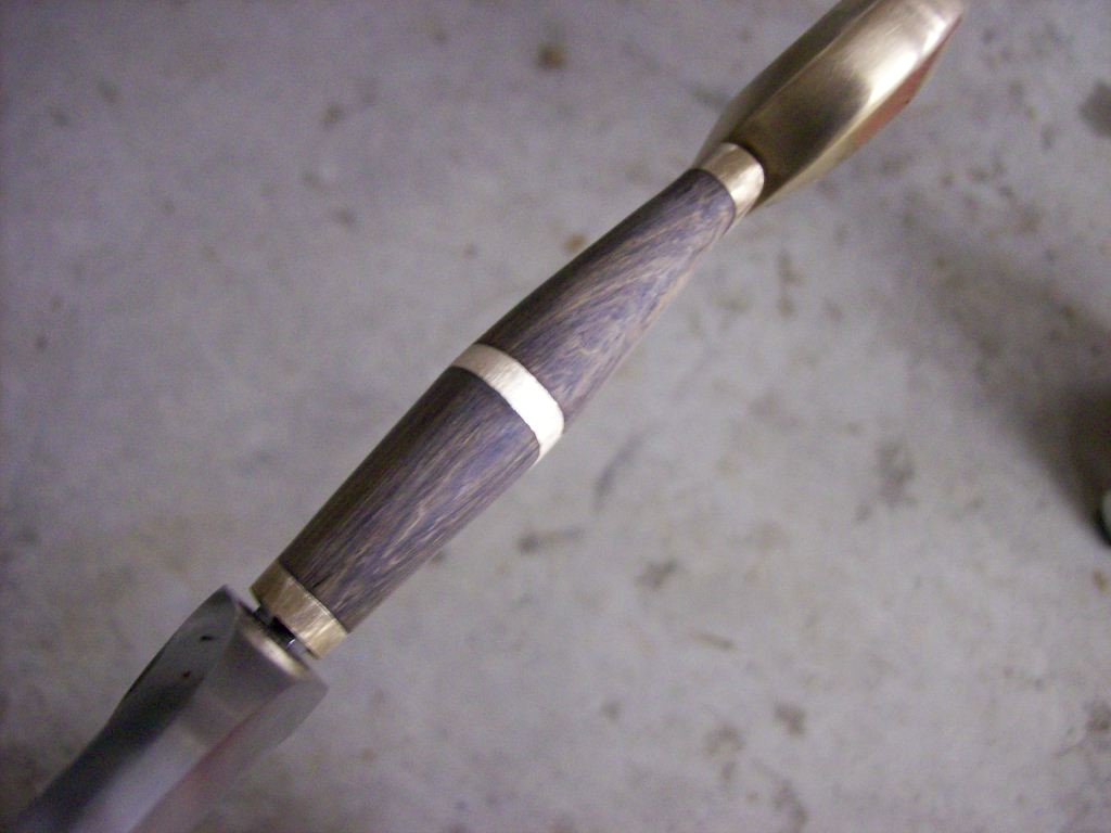

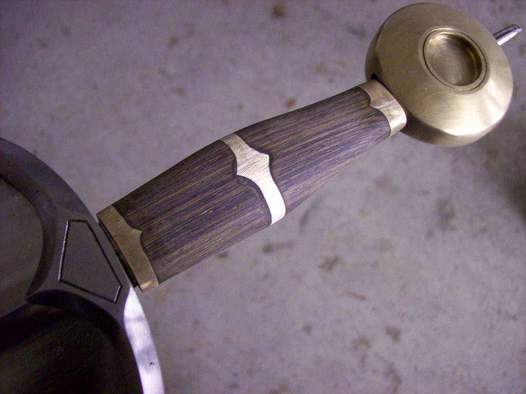

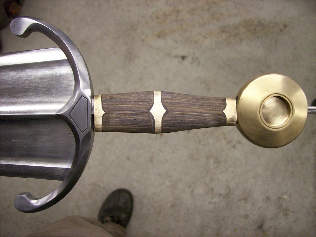

More progress pics as the handle is being built and roughed out.
This if pre-final fitting and polishing.
WOW ! I'm impressed and even more happy since it's my project. Wink Big Grin
Oh, if anyone wants to order the same, or almost the same, from Michael it's O.K. with me as I always find it more satisfying to have a design I commissioned be enjoyed by others rather than having an exclusive " one only " made.

Gorgeous. Simply gorgeous. Great piece there Jean. The grip looks excellent, not overdone but enough to be interesting. I am really looking forward to seeing this one finished!

Looks superb in all aspects Jean!
Were you thinking about adding something to the recesses in the pommel?
Jason
PostPosted: Wed 07 Apr, 2010 10:22 pm    Post subject:         Reply with quote
Jason
No not really as I sort of line clean lines and I haven't thought of anything in particular that I would like.
