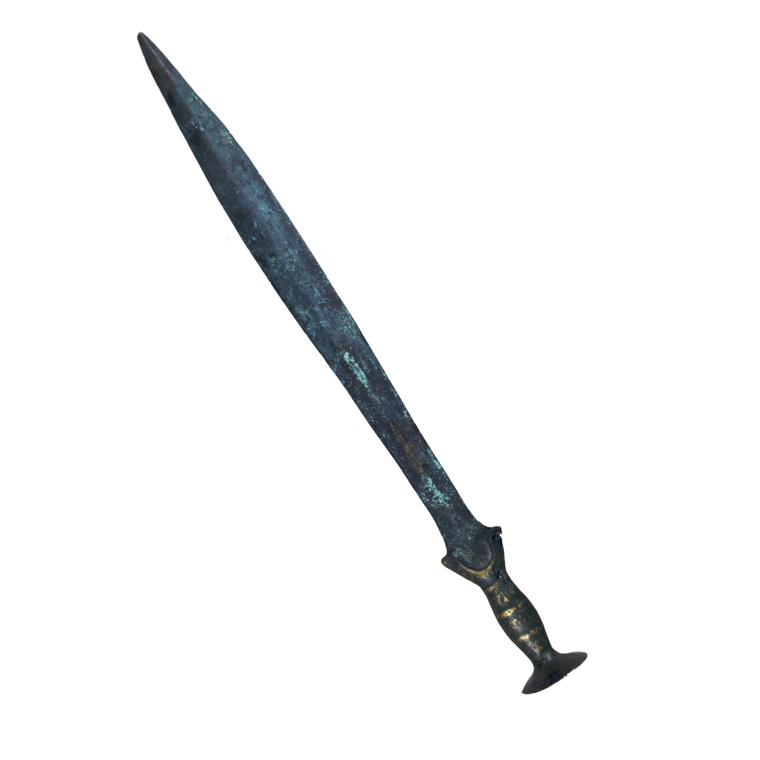

I recently joined this forum to learn more about ancient eastern european and asian arms and armour. I am doing research for a museum and need help in identifying two bronze swords, presumably around 9-7th century BC, and a pair of bronze embossed greaves, same time period. One is a leaf-shaped shorter sword, about 21 inch, the other is a long sword about 35 inches and between 2 and 3 inches wide. The images are attached. Any suggestions will be highly appreciated. Maria [ [/img]

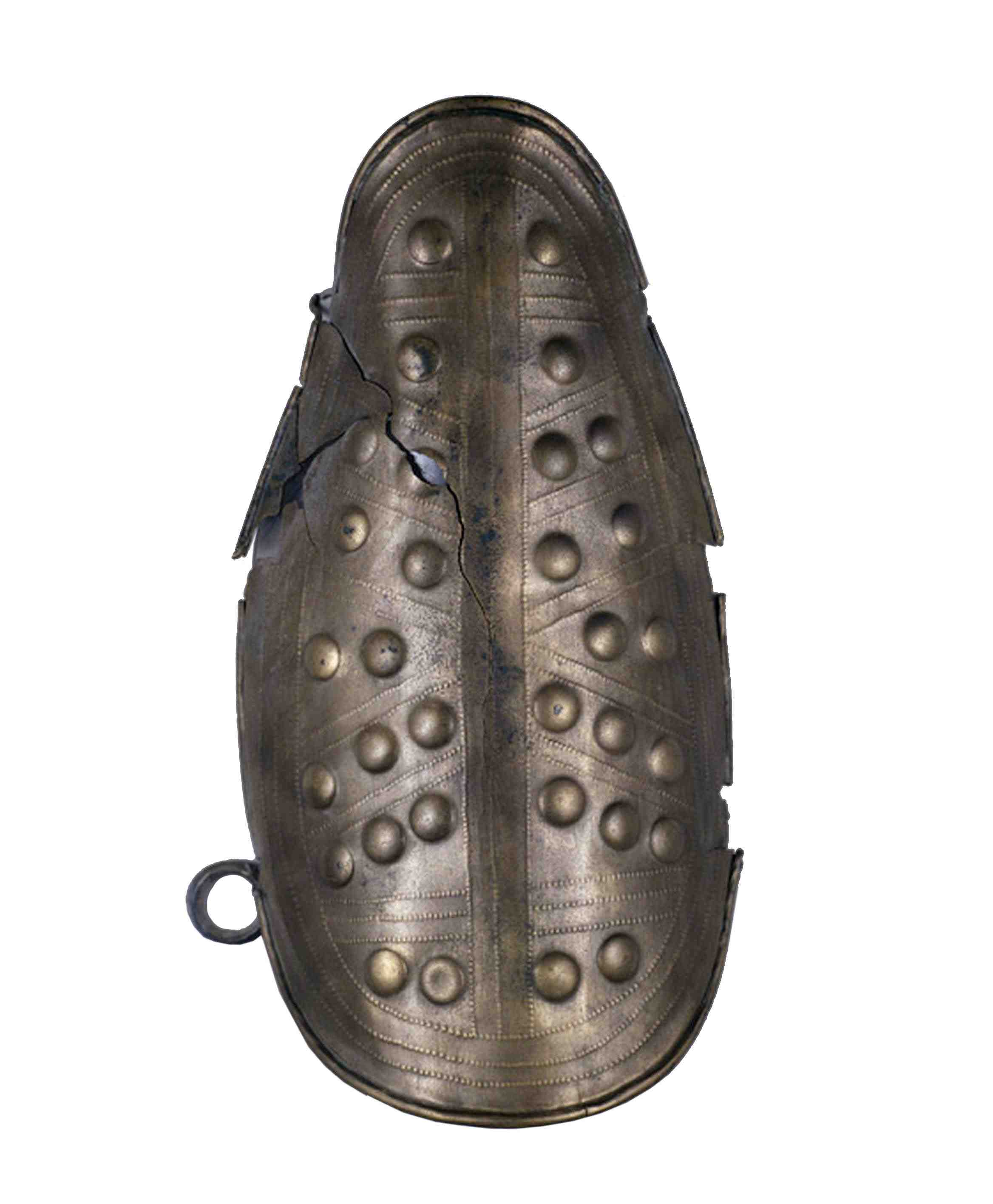

Here is the image of the greave. It didn't get attached to the previous message. Sorry!
Hi Maria, the first one seems to be an iron age sword usually used in mediterranian mostly Italy (Golaseca culture: 900 - 600 BC, probably Golaseca Ib), similar types were also used in latter times by Celts or even by greek hoplites (xiphos) however the length was different.

The first is a so-called Schalenknauf sword. These were common in most of mainland Europe, around 1300-1000BC:
[url] http://1501bc.com/files/vollgriffschwerter_de...ate103.jpg [/url]
(image from "Die vollgriffschwerter der urnenfelderzeit aus Bayern" by Hermann Muller-Karpe)

Thank you for this info. Do you happen to know where the Schalenknauf type swords originated?

Check the attached file for the image of the bronze greave.

well as Jeroen wrote the Schalenknauf sword can be found in large part of bronze aged/Iron age central Europe, including north Italy. I think that it refers to so called Eastern Alp circle, mainly representing the area close to the Danube river. Its origin may be quite close to the evolution of so called anténé swords depicted on the picture Jeroen posted. I cant give any closer detail without deeper search in literature but i think there are lots of publications concerning this topic....
to summarize: Schalenknauf sword was widely used in mostly preceltic area of Bronze age/Iron Age Europe...
for transaltion the name Schalenknauf names a scale or button at the end of a handle...

this greave is probably a piece from southeastern Europe weaponry in bronze age, similar ones were found in eastern Ilyria (present Albania) or Thracian territory located mostly in rich graves of chieftains or warriors. Im not quite sure about their exact origin. It looks like a local imitation of greek greaves. Contacts between these areas is well documanted in material culture.
for a better view try this link: http://www.salimbeti.com/micenei/armour4.htm , the greaves are located in CENTRAL EUROPE section.
