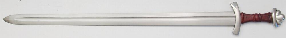

Hello!
I have a simple question - simple for you experts, not for me.
What do you think about the blade of the "Hedemark" viking sword, made by Valiant Armoury?
The fuller looks quite small.
But is it too small for a 10th century viking sword?
At least the hilt looks typically for 10th century - if you ignore the hex nut Wink
And also the point looks a little bit strange to me.
What kind of oakshot type is this blade???
This sword is so confusing.
Hope you can help me!

The fuller does appear suspiciously narrow for early Viking age. Some late 10th to 11th century swords (NM 11840, 3631, and 704 near the end of examples shown in "Swords of the Viking Age") do start to exhibit similarly narrow fullers. But, the hilt forms for those don't look that way (much more modern) by this point in the text. I would expect the fuller for that hilt form to be roughly in the range of 3/4 to 1 inch (20 to 25 mm) wide and to be fairly shallow on a blade that is roughly 1/4" (6mm) thick near the guard.
The point form is also more rounded and blunt than the examples I have in the same text.

With a fuller that long, you'll be looking at something in the X or XI family. A X would be the most typical for late Viking-esque swords. From our Type X spotlight:
This fuller is generally very wide and shallow, but in some cases may be narrower (about 1/3 of the blade's width) and more clearly defined
The fuller might be on the small side for a typical sword of the type, but a quick flip through Peirce's book shows some that may be close to being that narrow. The point looks a little abrupt to me, but I've seen much worse.
The hex nut is obviously not historical, as you've mentioned, nor is the use of stainless steel hilt components.

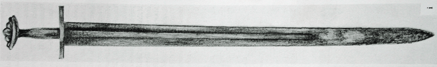

I tried to find a "narrow" fuller example. This type XII 11th century one from Records of the Medieval Sword has a roughly 3/4" wide fuller. (I have assumed blade width near guard to be close to 2", and scaled it photographically.) The point is more acute though.

So would you say this could be a rarely but still plausible viking sword (hilt+blade)?
There are at least 3-4 narrowed fullers in Peirce. As you'd imagine from the title "Sword of the Viking Age" it has more Vikign swords than Oakeshott's works, which typically cover later period (Medieval vs. Viking). Happy

I think you can see the type R or S pommel types falling near 10th century. But the more narrow and long length fuller is closer to 12th century according to his studies.
Yeah, I know that posting and it was the main reason for my doubts Wink
Well, it seems I have to find an alternative pommel and an alternative cross guard for this sword.
That will not be easy, I think Cry

The grip length (as measured by KOA) of 4.5 inches is not historical. The typical Viking sword's grip was so short that you supposedly had to put your pinky finger around the pommel in order to wield it.
Since most moderns dislike the short grip length, many swordmakers lengthen the grip at least a little to make the sword more marketable.

Since this sword does not appear to be modeled after any particular historical example I guess we can let our imaginations roam free. To me, it does not look like a true Viking sword but rather one of those early medieval swords that still had Viking stylings - the Xa blade and longer grip would be consistent with that idea. If you buy this interpretation, then I guess its historical (except for the assembly).
I owned one of these briefly and thought it was really nice esthetically, but with the prominent grip risers and thick, heavy, parallel-edged blade I found it rather uncomfortable to wield. A better (although more expensive) option might be the similar sword in the Fletcher/Trim 'chimera' line, which uses the same hilt components, a more conservative grip style, and AT's Xa blade, which looks almost certainly to be much lighter with a better weight distribution.

Let's not get ahead of ourselves. As I said, there are Viking swords with narrow fullers. That's proven. They're earlier than 12th century (which isn't Viking). The narrower Oakeshott typology blade forms (which is much of what Kirk was showing) typically do lie later in the period, but not all.
Getting hung up on typology things doesn't always help. The typology tracks the typical (hence the word relation). Happy There are always outliers.
I will say that if you're looking for a typical Viking sword, this one may not be it.
I am not a viking fanboy Wink
Actually I am only searching for an early medival sword.
Does that mean this could be one?
