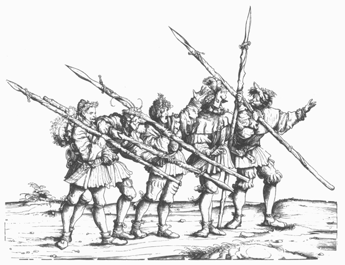

PostPosted: Mon 26 Apr, 2010 8:41 am    Post subject:         Reply with quote
In fact, Werner posted those images here some time ago. Here are bear hunters (spears/messer sets,) boar hunters (boar swords) and chamois hunters (socketed messer sets/light spears).
