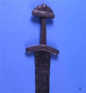

PostPosted: Sun 07 Oct, 2012 6:42 pm    Post subject:         Reply with quote
Jon-
The original was two parts. You can see the division between the pommel bar and pommel quite clearly in this photo of the original:
 Attachment: 14.89 KB
J. Hargis
Joined: 06 Feb 2012
Likes: 22 pages
Posts: 350
PostPosted: Sun 07 Oct, 2012 6:45 pm    Post subject:         Reply with quote
Tim Lison wrote:
Jon-
Tim, thanks.
Jon
