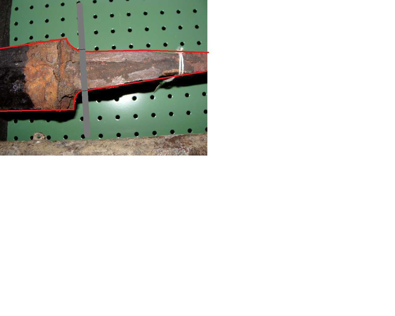

Hello,
The main reason I can think of is that most swords have rounded shoulders. A tang that meets the blade in a T shape creates a stress area. A simple rectangular cut in a guard will not slide all the way up to the blade (see illustration). The easiest way to cut a proper tang slit is with a dremel. It is a six step process.
I. Drill and cut a rectangle into the guard.
II. Slide it as far up as you can, note what makes it stick
III. Cut that area with the dremel.
IV. Once it is all the way up to the blade/tang joint trace the blade shape with a marker onto the guard.
V. Cut this traced area out.
VI. Clean it all up with needle files.
Hope this was of some use.
Hadrian
 Attachment: 130.17 KB
A rounded blade shoulder, and a rectangularly slit guard. [ Download ]

PostPosted: Thu 25 Mar, 2010 9:09 pm    Post subject:         Reply with quote
Hadrian Coffin wrote:
Hello,
Hadrian
Yeah my AT 1435 showed a little light when backlit as the shoulder of the blade was flush but not recessed partially into the face of the guard. Now since this was a finished sword drilling the hole fro the tang wasn't an issue but to recess the blade just a bit so that no light would show I used IV, V and VI using a file to cut at a diagonal angle into the pre-existing tang hole.
Going nice and easy the angled slot eventually was deep enough at the corners of the blade shoulder for the blade to be recessed by maybe 1/16" of an inch. The slanted slot did extend slightly wider than the blade at the guard.
If one looks at even an Albion the slots are not precision cut and my work was actually closer fitting ! This is not a negative as period tang and guard slots seem to have been fairly " gappy " as well historically.

PostPosted: Fri 26 Mar, 2010 5:05 pm    Post subject:         Reply with quote
Ken Speed wrote:
Jean, this is probably a stupid question that I'll regret asking but what is/are the IV, V, and VI that you are referring to?
Couldn't small gaps be filled with that metallic two part epoxy that I can't remember the the name of right now? Yeah, I'm having a senior moment!
You said, "Yeah my AT 1435 showed a little light when backlit as the shoulder of the blade was flush but not recessed partially into the face of the guard. Now since this was a finished sword drilling the hole fro the tang wasn't an issue but to recess the blade just a bit so that no light would show I used IV, V and VI using a file to cut at a diagonal angle into the pre-existing tang hole."
Oh, I was referring to the previous post that had a series of steps in making the whole for the tang and a groove for the blade shoulders to partially inlet the blade.
Nathan Gillelan explained it accurately. Wink Laughing Out Loud One difference is that I did it all carefully and slowly with a file rather than using a dremel. A dremel with a cutting wheel would do it quicker but with more risk of messing it up by going to deep or cutting a longer slot by accident by losing control of the cutting wheel.
One could fill the gap with liquid steel or steel epoxy i.e. epoxy that has powdered metal in it to give it a silvery colour.
Personally I don't find this to be needed unless the gap is really big or ugly/rough.
