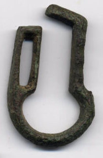

PostPosted: Tue 09 Mar, 2010 2:59 pm    Post subject: hanging bucklers         Reply with quote
There is a type of medieval belt hook that works very well for hanging a buckler. This one is from my collection, and would fit a 3/4" belt.
 Attachment: 10.92 KB
