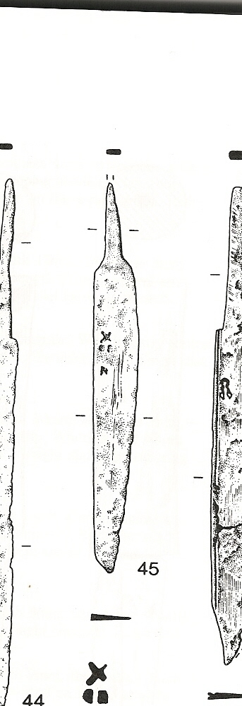

I scanned a couple of images of what I think could be considered some blades that would fall under the classification of "clip point". They're from "Knives and Scabbards" written by J. Cowgill, M. De Neergaard, and N. Griffiths, published by Boydell Press and reproduced here with permission.
 Attachment: 55.2 KB
86. Blade length 109mm, width 16mm, thickness 2mm.
 Attachment: 116.92 KB
Right of #45, Blade length 120mm, width 19mm, thickness 2mm, whittle tang length 61mm. [ Download ]
