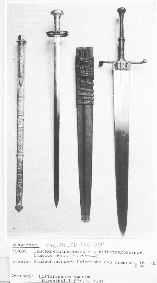

Here are the two main non-art historical inspirations for my scabbard. Both are relatively plain--even austere-- but obviously of good quality. I briefly planned to use a central rib on my scabbard and make a chape like the one on that Dresden Schlactschwert. I really want to make a version of that sword, though, so I'm going to hold those ideas in reserve. I leaned more toward the plain scabbard associated with the Dresden Hauswehr I commissioned from EBE, which is why my scabbard looks pretty good on the Hauswehr.
One of the things I didn't notice until I started this project is that the chappe of the Dresden Schlactschwert is shaped to completely enclose the tops of the byknives.
