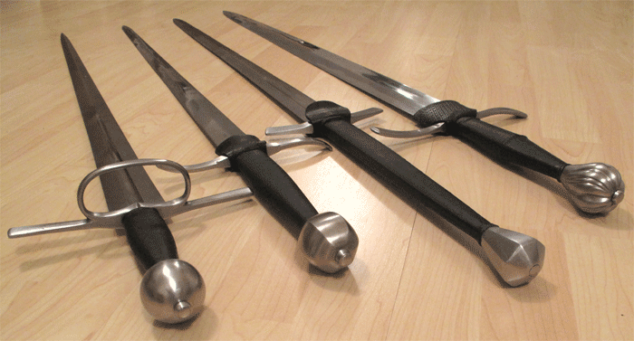

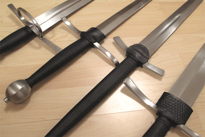

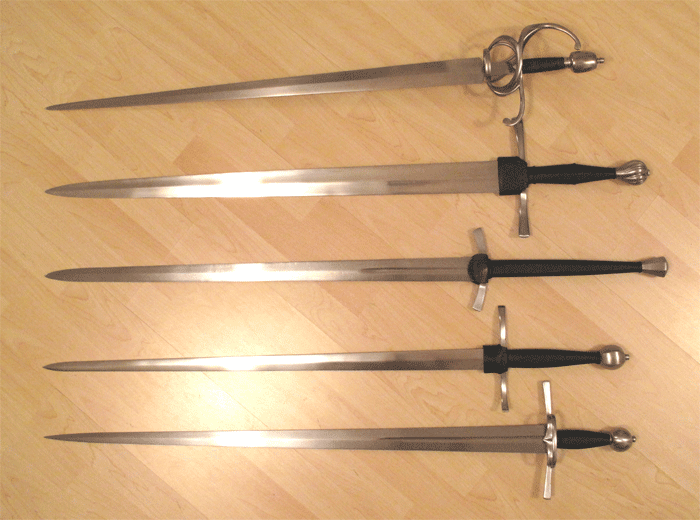

Here's the whole shebang, three of which I will soon be selling or otherwise disposing of to make room and funds for new projects. I'll keep (for now) the big Type XVIII and WONDERFUL A&A Town Guard. I also have a piece coming from Eljay in 2011-2012, and that will add some much-needed diversity and character to the collection, as will bluing the TG hilt. Not much variety in my own projects. Apologies for the truly disgraceful and lazy photos! Cry

Nice work and could even be a cottage industry of period upgrades of basically sound swords but of indiferent finish or detailling.
In any case selling them to be able to buy more and try out new modifications is actually purchasing the " experience " of learning how to do these things and the skills acquired stay with you even if you end up selling most of the pieces except for some particular favorites. Big Grin Cool
Sort of an evolving revolving collection that in most cases means you shouldn't regret too much parting with the finished project sword and go to the next to do it even better. Wink
On the other hand you should hang on to the best pieces at least until you have made an even better executed version of the same project sword or one very similar to fill the type niche in your collection: But maybe I'm over-thinking it and should just say " NICE WORK ". Big Grin Cool
Posts: 5,935
PostPosted: Wed 21 Jul, 2010 8:04 pm    Post subject:         Reply with quote
That's it exactly, Jean. I'm working my way through school. Big Grin
PostPosted: Wed 21 Jul, 2010 8:28 pm    Post subject:         Reply with quote
Thank you for snapping those photos of the swords grouped together. It's always great to see things grouped together for context. That's a hell of a group of swords there, Sean, and something about which I hope you let yourself feel some pride!

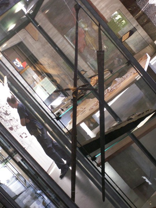

To finish this thread I could not withhold from you yet another Scandinavian Longgrip found in Lödöse, a medieval town 40 km upstream river and the predessor of thebig port city of Gothenburg on the westcoast of Sweden. This used to be border territory. The Danes constantly attacked. So they did in the winter of 1452 aswell. They were driven back in a blizzard but seemingly dropped this sword in the process I am not too sure all of these swords were danish though. It is definately a great sword for footcombat. We have made and tried replicas.Sorry for the bad pics. They are not mine. Bu at least they give you an idea. When I buy I new computer I will try to find more pics if you are interested. They now rest in peace on my external hard drive. I think this is the most extreme and longest grip of them all. It is almost longer than the blade !
hmmm seems the pics are to big to post. Will ask Eric on Gotland to resize themand post them as I have no Photoshop at the moment.

Sean, I think that will make an awesome gift! not at all jealous... Have to finish my own soon. Currently working on it with an hand file, not the most fun you can have in a cold workshop. It has taken some time extra but I'm also working on a new dagger and some riveted brass mail rings.

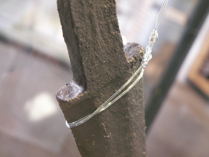

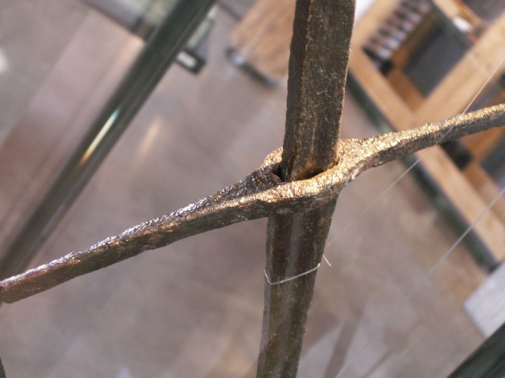

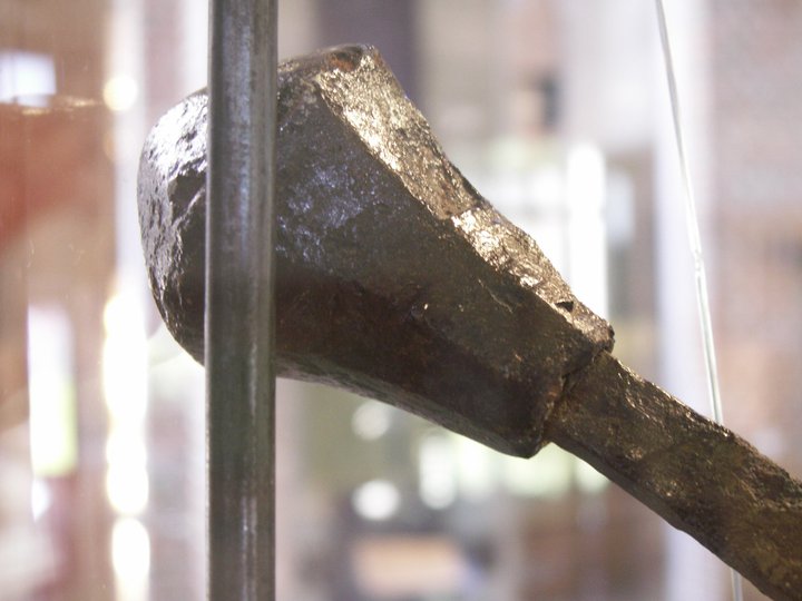

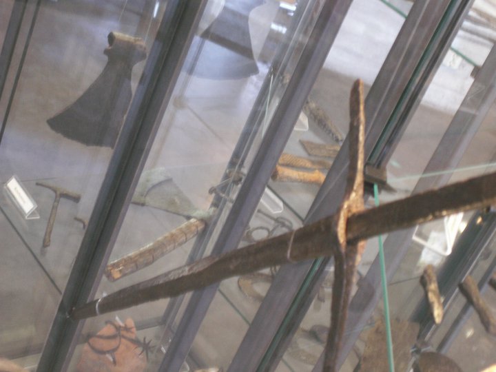

And here are Stefans pictures as promised!
/Eric
 Attachment: 93.28 KB
 Attachment: 50.38 KB
 Attachment: 54.24 KB
 Attachment: 58.17 KB
 Attachment: 52 KB

Oðinn's bones, now that is a long grip ! Could this be some sort of European equivalent of the nagamaki ?
What's the total length of the weapon ? I wonder how it was held and used ; it must have resembled quarterstaff techniques a bit... Only with a sharp blade, ouch. That handle must've been a hell of a fulcrum.

Those are enlightening photos! Thanks, guys!

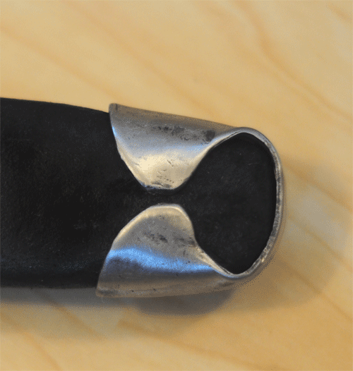

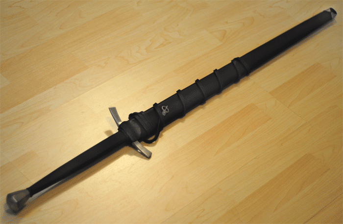

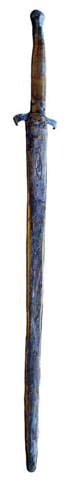

This is where the project ends! Just finished the scabbard and added the belt. This will be a gift to my nephew for his 10th birthday. It's not my best work and not really what I had in mind for myself, but the scale is much better for a boy and I'd have been thrilled to have it when I was 10 Big Grin
The scabbard was inspired by that of the Vättern sword discussed earlier in this thread, complete with my clumsy and too-short interpretation of that scabbard's simple chape. I couldn't figure out all the chape details from the photo shown below, but it's headed in the right direction, at least. I didn't bother to make it too neat or well-finished because that would have been out of character with the rest of the project (unfortunately). Looking at my own work up close here I see that I need to pinch in the edges of the chape a bit before shipping.
